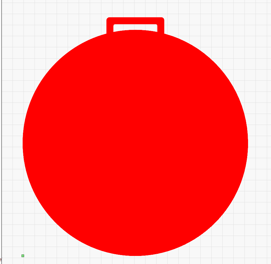

Lead on/Lead off headaches, climb vs conventional, pocket vs boss

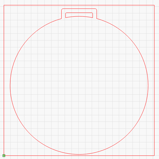

This is the shape I’m attempting to preserve.
I have it nested within a larger rectangle for a clean offcut (which can get scarred by bad lead-on and won’t cause problems in our production line)
I come from a machining background where I run CNC lasers, Plasmas, Waterjets, mills, and lathes. So I’m used to climb cuts on everything and arcing on from a positive radius.
When dealing with contours we usually arc on from the left side of the cut line. This means that we run clockwise around an external contour, and anti-clockwise around interior pockets.

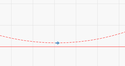

Thus my expected behavior is…
When selecting the following starts and directions:
However, reversing the direction does NOT flip the lead on to the other side of the contour.
My question is this… what precisely does Lightburn use to determine interior versus exterior contour?
I’ve attempted to toggle from line to fill and use the boolean functions.
I’ve also attempted to group specific geometry, while leaving other geometry ungrouped.
This is becoming quite an issue for us as we’re pushing out tons of new products and having to hand-hold each one, and add additional cut layers with the same speed/power settings, and all sorts of other hoops to jump through.
It’s really bogging down our efficiency on the much more complex and intricate cuts especially when we cannot get the lead on to flip to the correct side of the line on EVERY geometry with a single layer.
To go through our back catalog would be egregiously time intensive at this point, so is there another way to get the behavior I’m expecting consistently rather than using 2 separate layers with opposite direction lead on/off’s?
Cut Example.lbrn2 (12.4 KB)
AIUI, LightBurn assumes you start with a big sheet of stuff, from which you will cut an interesting (closed) shape. The perimeter of the shape is its outside border, so applying a positive kerf correction will make the shape larger by removing more of the big sheet material you don’t care about.
Another closed shape within that border puts a hole in the shape, so its border is considered inside: a positive kerf will make the inner shape smaller to maintain the proper size of the enclosing shape.
Again AIUI, count the number of line / curve crossings from outside all the (closed) shapes to the inside of the shape you’re interested in:
  • Odd number of crossings → the shape is outside
  • Even number of crossings → the shape is inside
In your example:
  • The enclosing square is outside = stuff you want (which is incorrect)
  • The circular shape is inside = a hole in the stuff (which is incorrect)
  • The little piece in the handle is outside = more stuff you want (which is incorrect)
Removing the enclosing square will make LightBurn’s assumptions match your reality:
  • The circular shape is outside
  • The little handle shape is inside
At least that’s how I think of it, which could be upside-down and inside-out. Other folks may have a better explanation. :puzzle_piece:

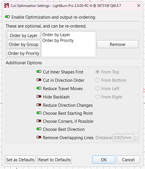

The Cut Optimizations settings may be working against you:
The Choose Best Starting Point setting lets it start anywhere, rather than at the first node of each shape.
Then the Choose Best Direction setting allows the cut planner to pick whatever direction it wants for each shape, overrriding the direction you picked.
I started out turning on All. The. Optimzations., but it seems they can work against each other to produce weird results, so I’ve backed off a bit.
In your situation, you may want to flip the Enable Optimizations switch Off to force the planner to use your shape start points and directions.
Alternatively, put the enclosing shape on a separate layer to achieve the same result while retaining the shape and cut.
Hi Scott,

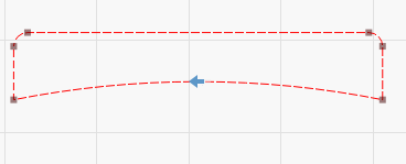

The settings in the example file you attached look ok?, the -90 degree lead in will set an internal lead in, which suits what you are doing.
The start point for the outer box needed to be moved - I inserted a node (using ‘m’ to create a node at the midpoint while in Node Edit mode) in order to move the start point away from the corner (where internal lead-in’s won’t work).
Is this what you wanted?

What I NEED is for the lead on to always be the SAME 90 degrees off the starting direction.
Not for something to override that and make an assumption about a particular piece of geometry.
If you flip the direction -90 becomes oriented +90 to the actual direction.
That’s fundamentally what’s the issue.
How do I correct that behavior?

Tried disabling optimizations didn’t help sadly.

The outer box is exactly relevant, because it causes LightBurn to regard the disk shape as a hole.
