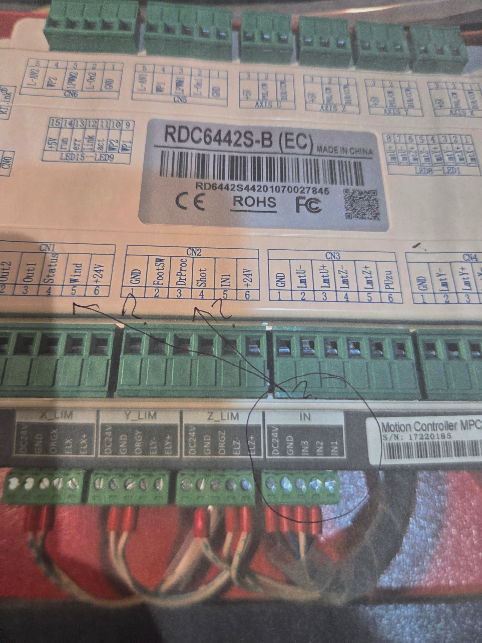

Leetro controller mpc6565 to Ruida rdc6442b
Trying to figure out pins on the leetro mpc6565 IN block to the Ruida pins any info on the pins I’m on my last block to wire:

These are easy:
  • DC24V → any +24V terminal in CN1 or CN2
  • GND → any GND terminal in any block
However, you must trace the IN1 and IN2 wires to whatever thing they come from, figure out what that thing does, then decide what’s appropriate on the 6442 controller. There is no shortcut: nobody knows what those two wires do.
(I edited your message to put the text in the body, rather than as a flyover for the picture.)
Thank you Ed the wires go to two inductive proximity sensors do you know where they go on the Ruida my guess is CN-1 ??
You must know what the sensors sense.
Assuming one senses the lid position, then CN2 → DRProc seems appropriate.
The water flow sensor should be wired to the WP terminal in the active laser in either CN5 or CN6, with GND & power as needed.
That blocks seems to be all output & status, so external sensors don’t belong there.
