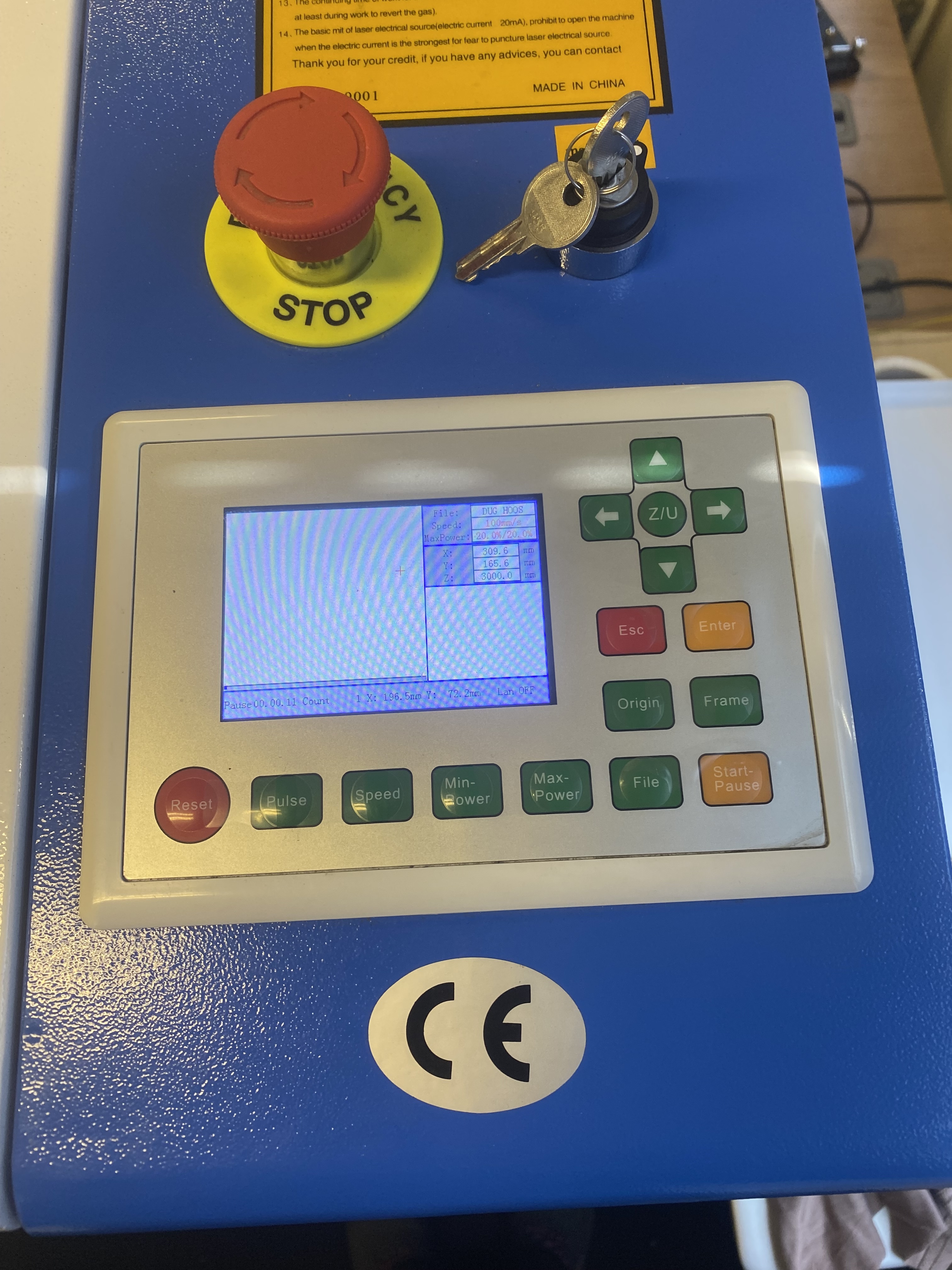

Does your machine have a Ruida controller…?
Where is it showing that there is a coolant flow error?
Thankyou! Yes it’s showing on the control panel display on the laser. I’m wondering if the water flow is not strong enough to trigger the sensor in the water flow sensor?

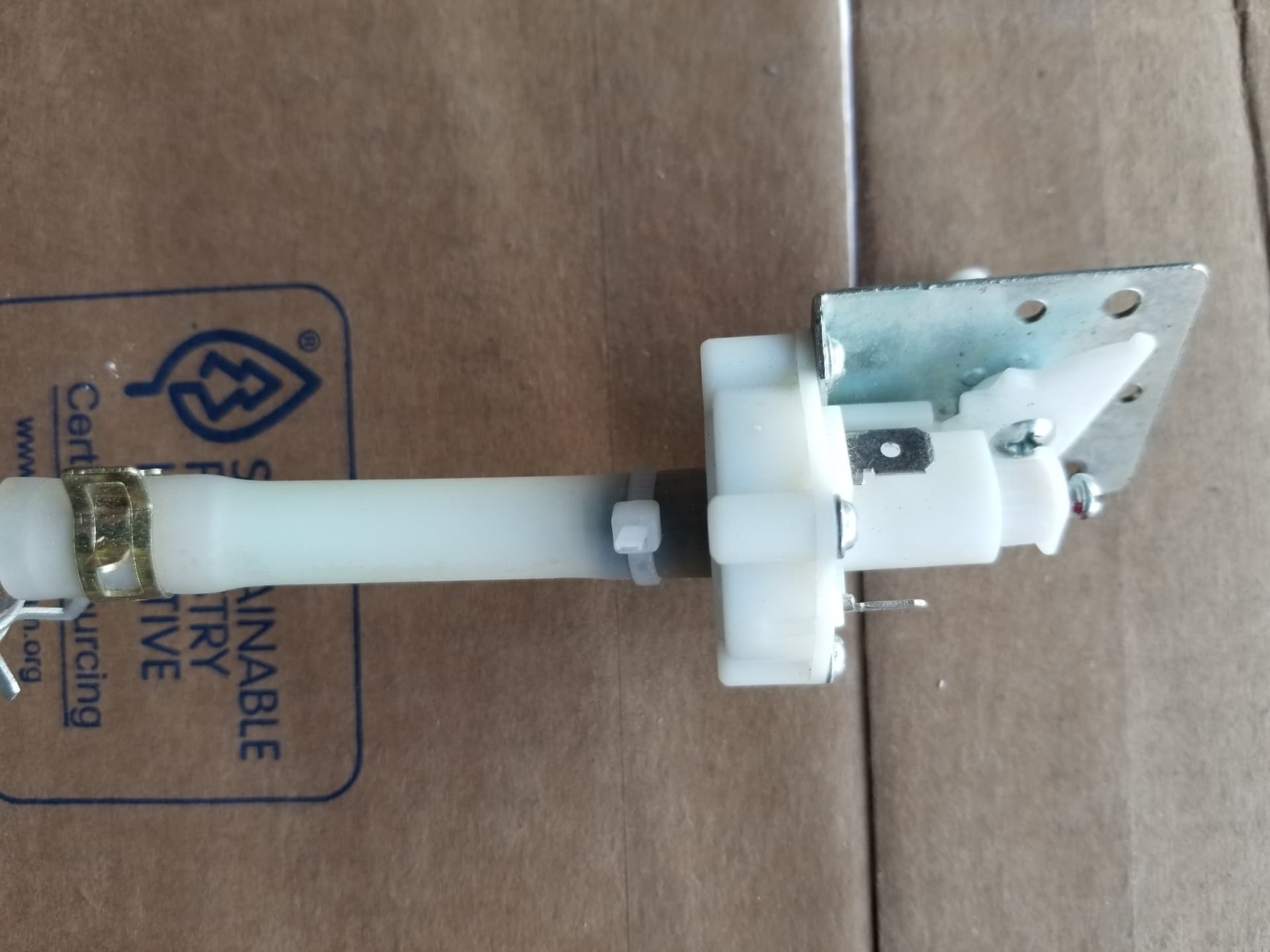

You said the pump melted down and the lines were full of…something… Did you pull the flow sensor and check it? It may be full of trash.
Yes I disconnected the water flow sensor, flushed it out and tested it. The multi meter was showing it had power when triggered but still getting water error message. I have ordered a new water flow senor to eliminate that problem. Although I must add that I was sometimes getting a water error before this incident happened

Most of these flow valves, like mine is really a pressure switch with only a diaphragm inside to measure pressure, not flow.
I have a hall effect flow meter..

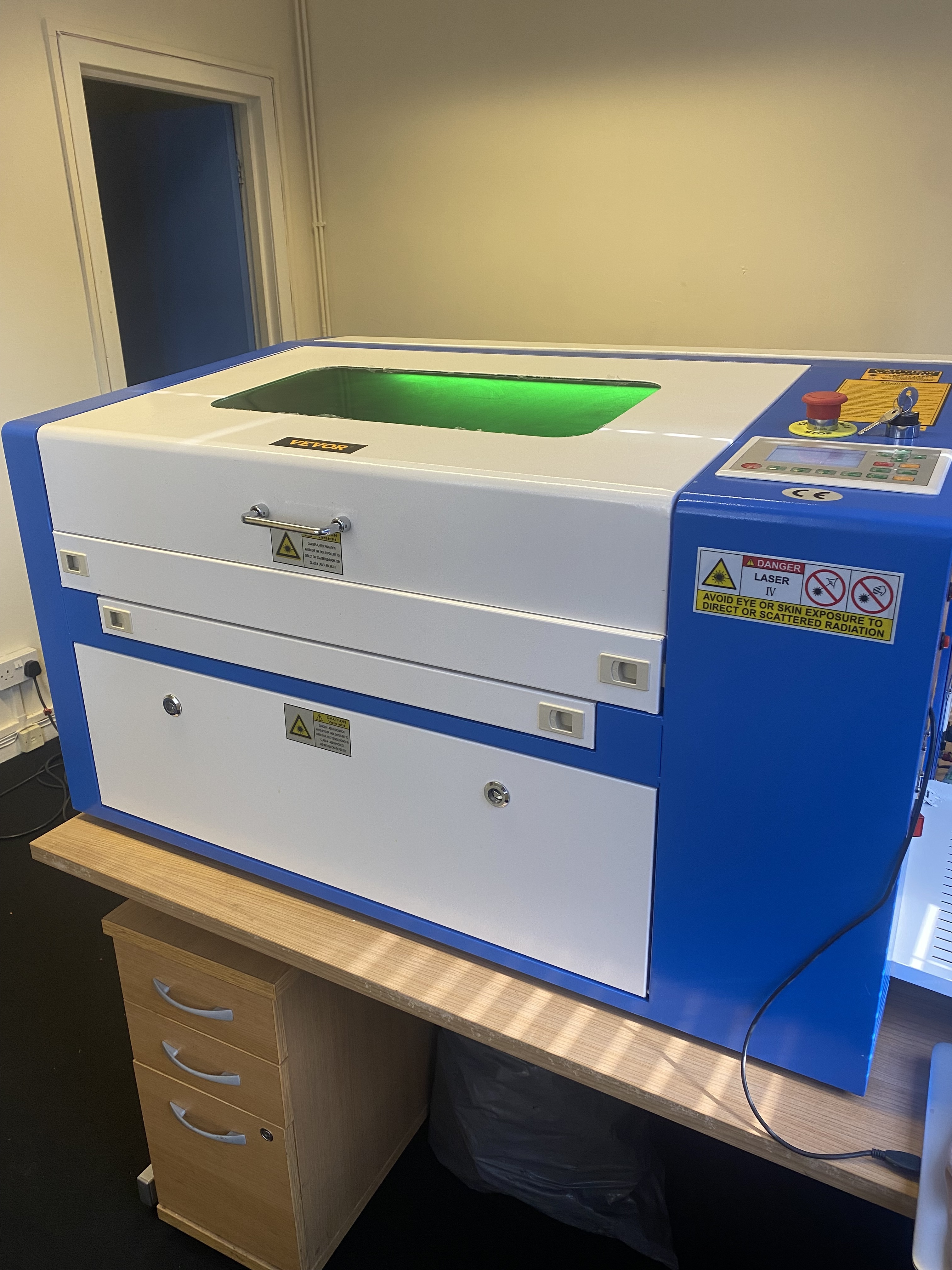

Sorry I don’t know the name of the controller but I’ll send pictures of the controller and laser.
The laser itself is less than a year old and well maintained, apart from this mistake with the water, hoping there is a way to possibly reset the system?

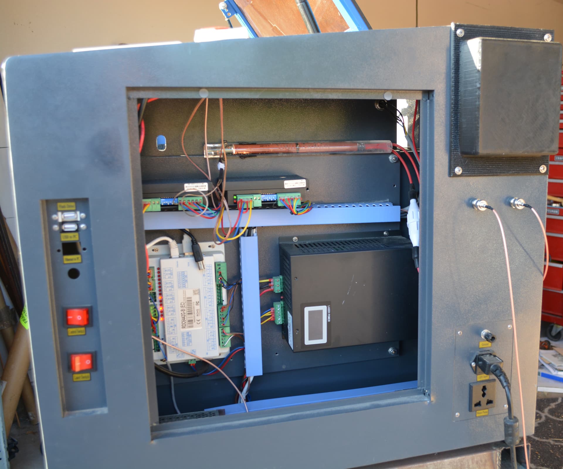

Nice machine, I have one very similar… This picture is when it was pretty much stock.
The machine console is very much like yours, so I’d say you have a Ruida controller…
If you open the electronics bay door you can identify which type of Ruida you have… There is no standardized layout of where the components are located, but you can see what mine looks like…
Left of the blue wiring tray is the Ruida controller, you can read the model off the case… On the right it the laser high voltage power supply (lps) which is the high voltage that causes your tube to lase, hence dc excited laser. Rith above the horizontal blue bar is the pair of motor drivers… one for each axes. You could have three if the machine has a controllable Z axes.
You can read that mine is a 6442G model… probably what you have…
If you are not getting any arcing to the case from the high voltage power supply, it would indicate there is no hv being generated by the lps.
You can manually test fire it from the lps, but ensure you have coolant flow.

Thanks for taking the time to explain that to me, I really appreciate it. I’ll attach a photo of the model. I have tried to test it and pulse it and nothing is happening, could it be because the cooling ring has cracked off? I listened to someone’s advice on another forum and reset the controller and it’s sent my machine wild, reversing all the commands so up is down, left is right etc and every time I switch it on, the laser head is slamming off yeh right hand side of the machine. I feel I am adding to the problems trying to fix it :weary:
If you didn’t save the vendors setting before the reset, you may have shot yourself in the foot.
If you do a factory reset on a Ruida, it does just that, resets it all to the default settings, and all vendor information is lost, probably why your machine went crazy…
You need to find that information, either from someone with a very similar similar machine or from your vendor.
