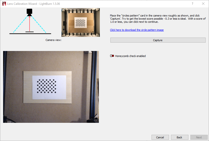

Lens Calibration Wizard capture button not working
Hello!
I’m trying to configure a Logitech C920 on a Sculpfun S30 and I get a picture in the Camera control and the Lens Calibration Wizard, but at the Capture step, the button does nothing and there is no message.
I selected the HD Pro Webcam C920 with a Standard Lens and also with the *Fisheye one. I removed the Honeycomb bed as well, but when I click on the Capture button, still no indication of any action taking place.
I’ve run Lightburn in Windows 8 compatibility mode and as Administrator, but the button still doesn’t seem to call any function.
I’m running LightBurn 1.5.06 and Windows 10 22H2.
Is there something I’m missing?
If tried a different computer running Windows 10 version 2004 and reinstalled different versions of Lightburn (1.3.0.1, 1.4.05, 1.5.06 and 1.6.00) all behave in the same manner when pressing the Capture button. No reaction to the button press event.
So I decided to install MX Linux. Webcam seemed fine as Lightburn saw the webcam in the control window, but in the Wizard a black screen was all that I saw.
Looking at the documentation, I thought I might as well install the recommended (my least favourite Linux distribution) Ubuntu 22.04. However, Lightburn just crashes instantly. I did install 22.04.4 so there might be an issue there?
Any thoughts and input would be greatly appreciated.
Have you tried changing the following settings?
Thank you for your reply parsec.
I did play with those settings and changed Full Color to Black and White, but I’m not sure about the Default Capture System. I’ll have a look.
OK, I was about to get Windows 7 installed and give it another shot… but thanks to your reply I checked the settings and it was set to custom! I changed it
It works!
Thank you for your help! :smiley:

I am having this exact problem with a c920 camera.
The funny thing is that it once and only once started to go past the first screen on the “lens calibration wizard” But before that and after hitting the capture button does nothing.
It would be really helpful if it actually gave some kind of feedback as to why it’s not doing anything.
This is my only webcam to play with - and I don’t intend to spend more on a better camera if it can’t even work with this one.
Hello Nixk,
Did you change in Settings the Camera Capture System to Default Capture System?
I will try that again.
What exactly does that do?
