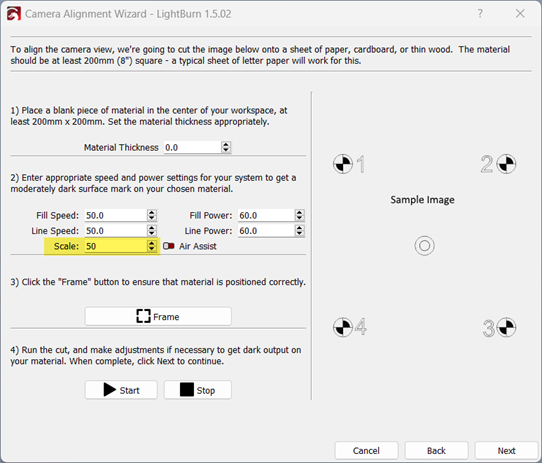

Scaling up the alignment burn so the targets are much further away from each other should also assist with your issue (and improve the accuracy of the alignment):
Initially the scale was at 193, but it was too large for the 8" piece of wood I had. When I set the scale to 100, it fit right on the 8" wood. I would think 50 would make it way too small.
I was just highlighting where the scale adjustment is. If you have two planks of wood or even some cardboard you can spread them apart as you only need material under the targets. And for the best accuracy, perform the alignment using a material the same thickness as the material you will most often be using with the camera.
