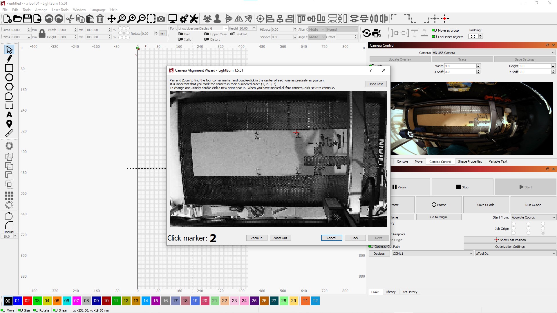

I ran the lens calibration, which took a while because of lighting issues. Finally got it and tried running the camera alignment. Burned the image successfully and it was seen by the camera. I zoomed in, double clicked the number one target and the box said to click on number two. When I double clicked it, it put the red crosshair on the number two target but never goes on to numbers three or four. Restarted Lightburn several times with the same results. Running on Windows 10 with ELP-USB8MP02G-L180 camera.
What happens instead?
It just stays asking for number two.

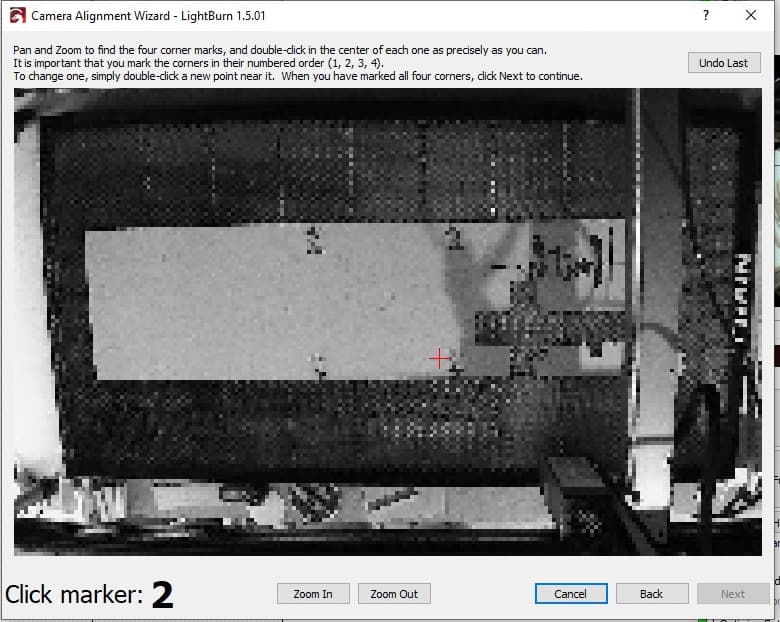

Thatās odd. Can you take a screenshot of what youāre seeing?
No Targets selected
Target 1 selected
Target 2 Selected
Target 2 selected off target to show that nothing changes.
Thatās odd indeed. I have not seen this before.
If you continue to double click 2 or 3 more times elsewhere on the screen, does anything change?
Asking @JohnJohn if heās seen anything like this before.
No. It keeps saying āClick marker: 2ā It will put the crosshair wherever I double click, but it will still keep asking for marker 2. When I double click the new location, the prior crosshair moves to the new location, but never accepts the point so it never moves on to asking for the third point. At no time are there more than two crosshairs. One at point one and one where I double click for point twoā¦

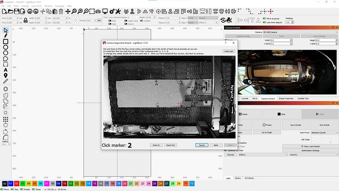

At the recommendation of someone I trust I updated from Lightburn 1.5.02 to 1.5.03 beta, since 1.5.02 had known camera issues. The only difference that I am seeing is that now when I select point 2, the crosshair on point 1 disappears. It still wonāt allow me to select points 3 and 4, but forgets point 1. Hopefully Lightburn will fix this before I have to decide to return the camera. Itās obvious that the camera is working, but too expensive to buy and not be able to use. Iāve only got 20 days (approximately) left before my return window closes.

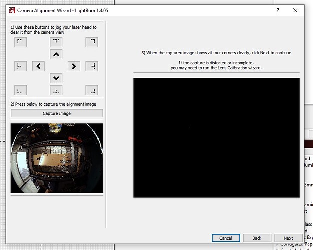

Rolled back to to 1.4.05 and am still getting the same results. Iāve been using Lightburn and my laser without the camera thus far, so maybe Iāll just have to stick with using it without the camera. The camera works with other programs, just not with Lightburn. Other people are using the same camera, so Iām at a loss. Iāll wait until I get a response from Lightburn, but Iām not very hopeful at this point.
Before giving up Iād suggest taking a looking at Edit->Settings->Camera Control System.
If set to Custom, try Default. If Default, try Custom. Then retry calibration.

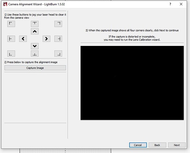

My Camera Control System was set at custom. Setting it to default allowed me to see the camera view, but when I clicked on capture, I got a black capture instead of the image (Lightburn 1.4.05).
With Lightburn 1.5.02 and 1.5.03 using default Camera Control System settings I got no preview and capture was just a black field. Setting it back to custom allowed the capture correctly, but would still not let me select more than the one point.

@JohnJohn discussed this with us today, it seems to be related to the lack of resolution shown in the image that you are getting, likely compounded by the nature of the 180deg lens as it looks to me that the working area crop could be also cropping away over 70% of your resolution:
With the low pixel resolution, target 2 will not be registering because it will not be far away enough (in pixels) from target 1. You can test this yourself by gradually clicking further away until the second target is registered.
If you were to put LightBurn into debug mode (Help>Enable Debug Log), and then go into the camera window and change to āNoneā, then back to your camera again, close LightBurn and open the āLightBurnLog.txtā file in your documents folder, you should see evidence of LightBurn communicating with the camera, enumerating available formats, and selecting one. If you attach that file here it might help explain the resolution you are getting, and there may be a way to improve that.
But basically, if the resolution cannot be improved, and/or you cannot move your camera a lot closer (like half the distance), you will likely need a different camera.
