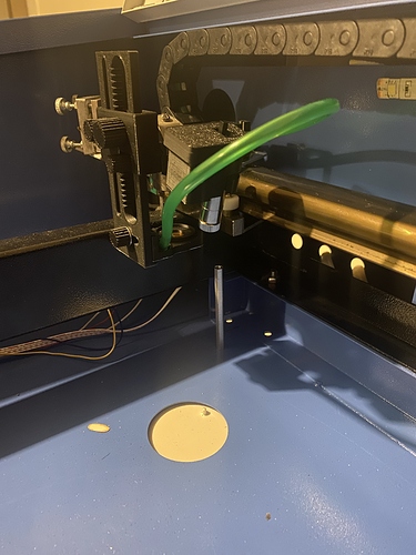

Can you post some pictures of the assembly, lens, and mirror?

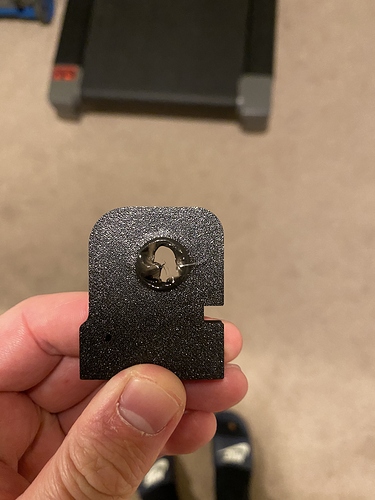

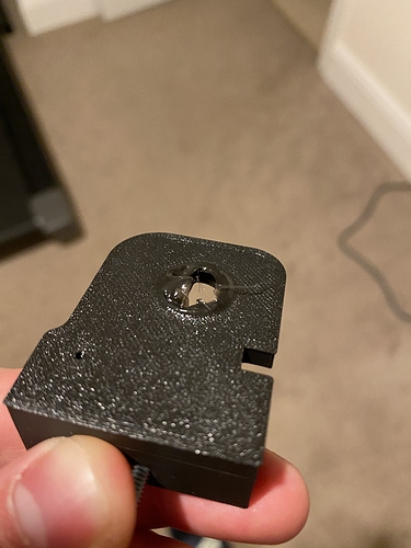

that’s the holder - the heat distribution is symmetrical

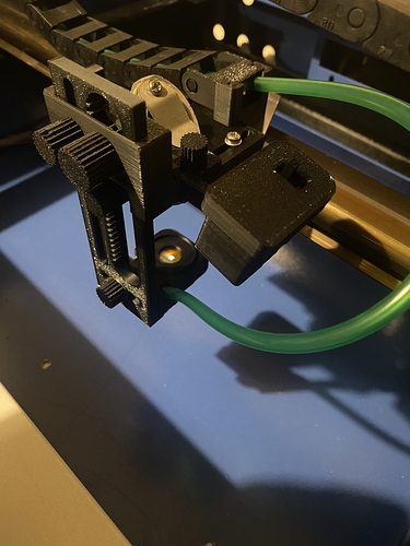

I do not understand how this fits together or is assembled on your particular machine. Can you illustrate that in a picture?
Also, that appears to be 3D Printed and it may not be the most suitable material for this application. Is it a 3D printed part?
here is a picture. Yes, it is 3D printed
Unfortunately the design of your lens holder assembly (laser head) is not ideal. It is my recommendation that you change out your lens holder assembly with one like this:
  • Your lens has very little cover / protection from particulate contamination on the top surface. A tube holder will greatly reduce the chances of this because the open entry for the laser is vertical and to the side of the lens.
  • Your air assist does not pressurize the area of space within the lower section of the lens like a tube and cone assembly does. This is a very effective means of protection from smoke and soot collecting on the under side of the lens.
  • The material used on your holder combined with the design does lend itself to explaining the heat soak on the lens as well as the melting.
  • You will have more stability in the metal lens holder assembly that may improve your overall quality in production.
