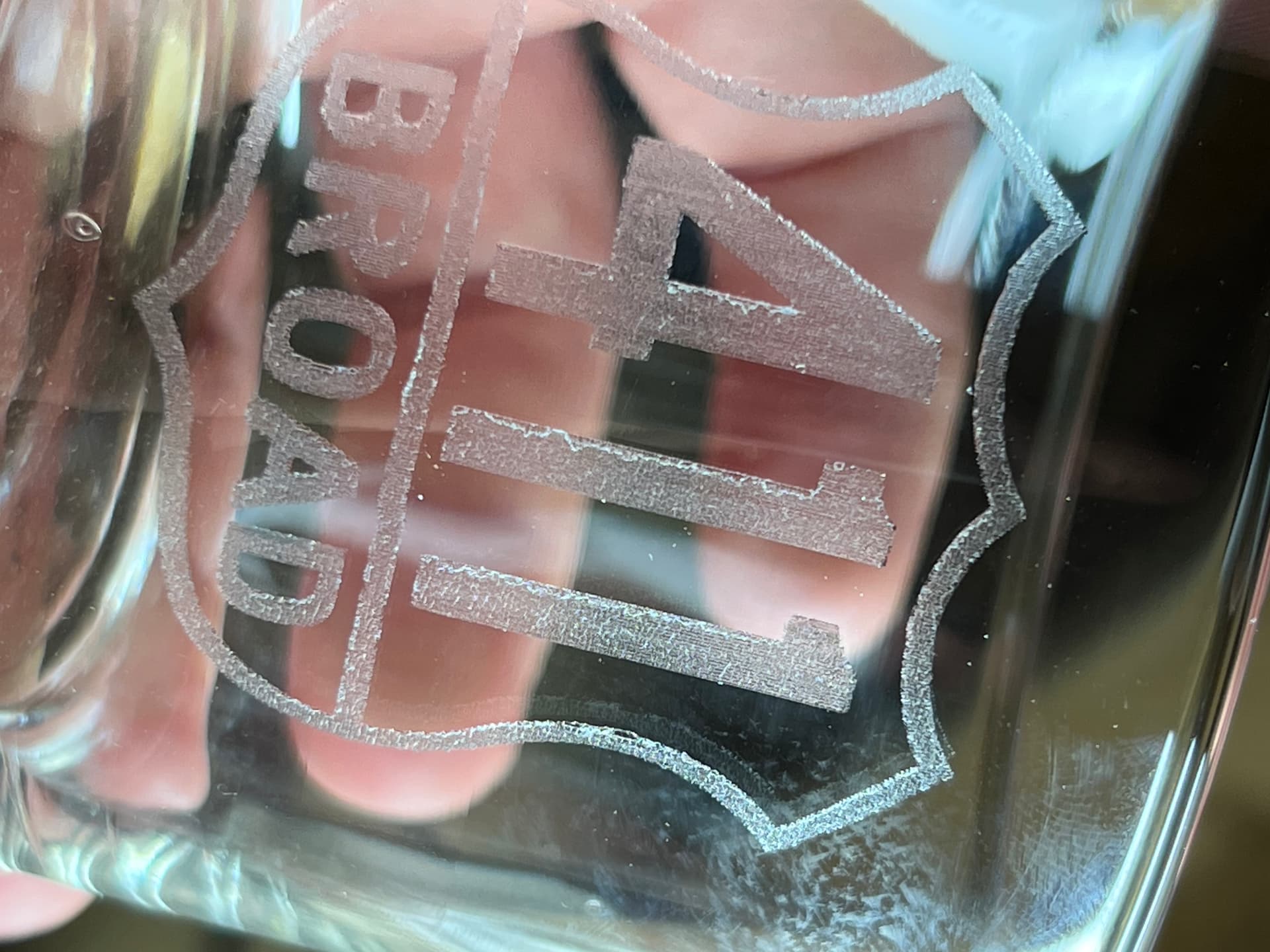

Iv looked through some of the threads and watched a ton of videos and maybe I’m just approaching this wrong but I cannot get this right. Im engraving off of an svg file and my line lpi is like 254, iv tried high power high speed and now im lower power(20%) and at 22ips for my most recent attempt which has not yielded my favorite results but for sure less chip out. I’m also using a thin lay of dawn and no air

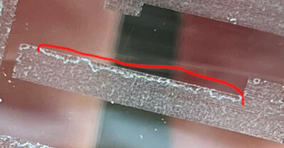

Looks like it’s powering off some of the glass.
I had a glass guy advise me to use steel wool on glass to ensure all the shards come loose here, not in someones hand or finger.
Just the dawn, if I’m going to just knock it loose should I just up the power to get a better look before I do it? When marketing these is that the way people do it before they sell them?

Have you tried putting down a layer of wet newspaper and etching that on top of the glass? I’ve heard that gives some decent results, but cant recall where.
CO2 will cause chipping like that when just blasted without any surface cover, in my experience.
You are using a diode laser, right? it’s simply the wrong tool. You can make it work, but it will take much testing. It doesn’t look too bad, just continue. Try a different coating maybe. And it can also be the material itself, maybe try something different. There are many types of glass.

I have a 90W CO2, honestly I’m beginning to agree with the material thing. I ordered these from JDS but I was looking back on a glass I picked up from dollar tree and it looks great compared to these and I wanna say I used the same settings on them. So maybe this glass is more suitable for a UV laser but I’m gonna run some more test.

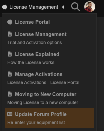

To update your profile, go here in the top menu:
@jkwilborn My apologies, I went to update it when I first got it and upgraded my license and I didn’t find it and then it slipped my mind. I fixed it though
