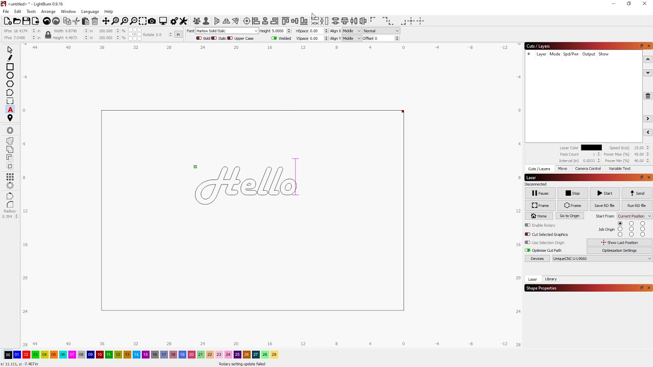

Hi Guys…I’ve scanning the interweb for a font where all the letters in a word are connected with no spacing. I need to cut out some Welcome signs but for the life of me I can’t seem to find anything. The gosh darn W is always separated.
Is there a way in lightburn to do letter spacing?
That would be such a great add to this program if it is not available.
You can adjust spacing. image
You might want to review this first. https://lightburnsoftware.github.io/NewDocs/FontsAndText.html
You also have other options for addressing this.

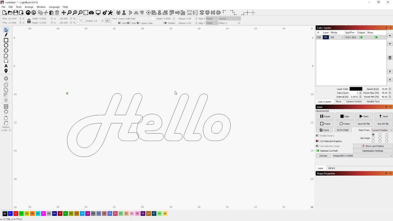

  • While it will render the text to no longer be editable as text, you can always convert this text to paths, allowing you to place each individual shape as you’d like.
  • You could also use a swash or another graphic element along the bottom to provide you connection points. Some fonts are provided with what is known as Ligatures and Stylistic Alternates that also could be used to achieve the look you are after.

What @Rick said about adjusting the spacing:
And what @Rick said about converting the text to paths:

I just tried the option provided in LB.
It did just what I wanted
Thanks everyone!
