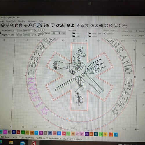

I read a couple of topics that seemed to address this but i couldn’t seem to make it work
I want the letters in the circle in relief. (I will change them all to same mode when i get it figured out)
The circle will fill but doesn’t recognize the letters.
bernd.dk
(Bernd )
2
Make sure your letters are closed and the two circles closest to the text are on the same layer.
You can send your file if it doesn’t work.
JimNM
(James )
3
Show us your preview results. The program sometimes will flip a display setting that will not show fill layers as solid on the work space.
Check to make sure your display is showing filled shapes
GLettuce
(Nancy Ellis )
4
Hi, how do I send a file?
JimNM
(James )
5
Use this button in the top row of your REPLY window to upload the file to this forum…
