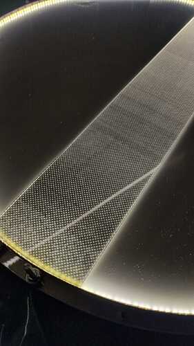

I am trying to engrave a LGP (light guide plate ) dot pattern for a lumianre, and I get these weird lines on the X-axis . I work with a 150 W laser tube, and I have the settings as the image shows. I also tried with the air assist, but the result is the same.
Any advice would be highly appreciated!

I’d guess the power supply is failing and does not shut off properly after the last pass.
That photo shows a line with a dotted texture mimicking a single scan line, but it appears both defocused and done at a wider spacing, neither of which seem due to controller settings.

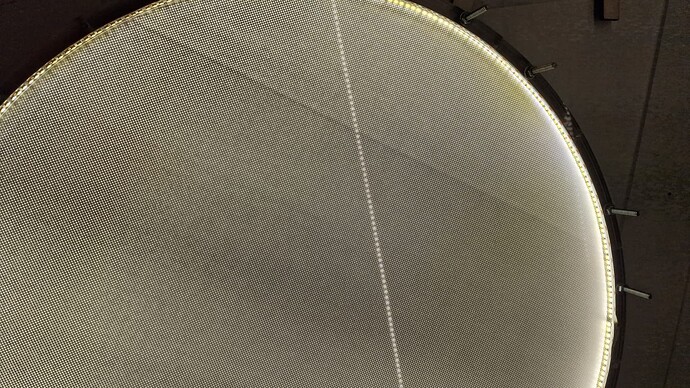

Could you highlight which bit is the weird bit? It’s circular, so we don’t have any reference for what is the x axis!
The last image is with the pattern in RD works
It does look like a difference in focus. I’d make sure the axis are clean, nothing’s binding up etc. if you move the head by hand, can you feel anything different in those areas versus the rest of the build area? Is the bed clean?
