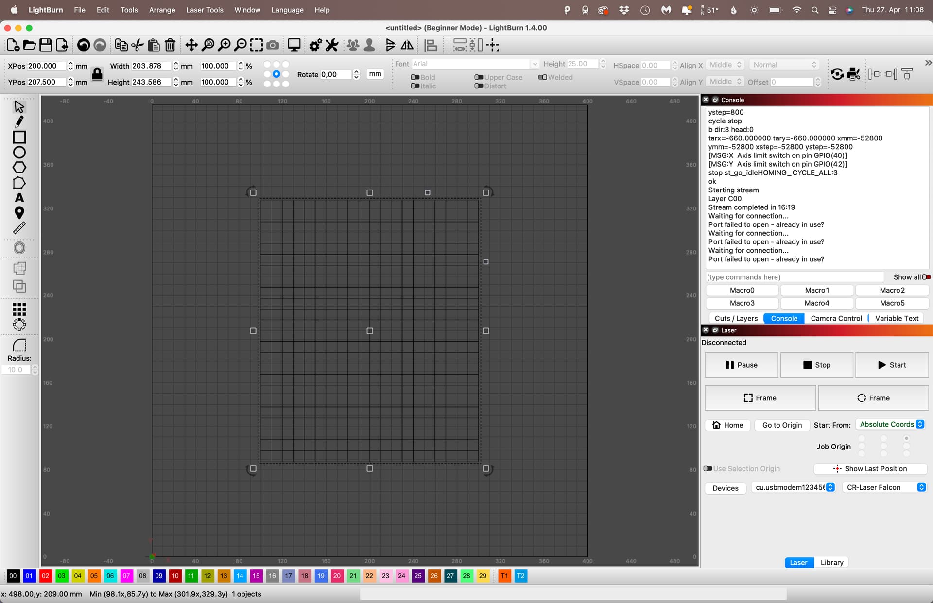

i just purchased a license for lightburn and inserted the license key and activated the software… the big problem is that i did this while i was engraving an important grid on my baseplate and it interrupted the engraving WTF!!! now it wont let me resume!! It has ruined my baseplate!!! i’m really livid, this is a huge disappointment with my recent purchase… how the hell can this happen on such important things??? Engravings can’t be reversed…

Like i mentioned at the very beginning this happened when i entered the activation key i had just purchased, i was engraving happily away and the activation key caused the disconnect and subsequently ruined the engraving…
There is no other software using USB at all nor did i have anything else in USB at that point…
Timing may be coincidental. Activation wouldn’t somehow hold the port. It’s also possible that the laser is in a broken state after being interrupted. Can you try resetting the laser if you have a reset button, else try power cycling.
the only way was power cycling which inevitably sent the laser head back in its home position. Prior to turning on i disabled the “auto home” function in Lightburn which failed, it returned home when i connected to Lightburn again
If the controller was not responsive then position would have been lost in any case. If your machine is configured to home on power-on the LightBurn setting for auto-home on startup won’t change that. It will only not re-home when LightBurn connects to the laser via serial-usb.
Note that power-on and connection are discrete things. If the machine homes on all power-on it will do so irrespective of connection. LightBurn “auto-home on startup” setting only changes the behavior at connection time.

Hold up everyone, while we all may have had experiences with doing more than one thing “issues” before, LightBurn should not be doing this. We have checked the code and are currently discussing internally to determine what might have happened and how to ensure this is not the case moving forward.
Everyone, might be a good time to breathe, while we look into this further.
When you enter a license key and activate it, there are things that might become enabled that weren’t before, so we do an “internal reset” and reload the device list, in case that list contains devices you weren’t allowed to use with your previous license config.
I honestly don’t think I’ve ever heard of anyone ever entering their key while a job was actively running, but we’ve discussed this internally and agree that we should probably make LightBurn smart enough not to let you do this, and tell you why.
We’re going to make that change, and give you a 1 year renewal as an apology for screwing up your engraving.
