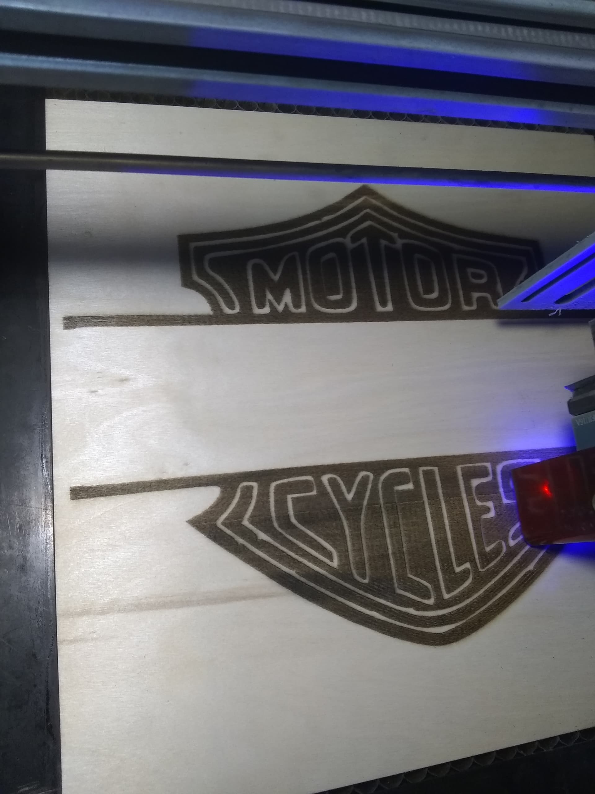

THIS JUST HAPPENED A COUPLE weeks ago i go to engrave a 12 x 12 inch balsa plywood and it doesnt matter if i stsart from the bottom or top after about 1/3 thru the burn lightburn locks up, nim able to save the work rebbot it all then start from oposite direction but again locks up at about 1/3 way thru which really messes up my material aND TIME WAISTED THIS ALL STARTED AFTER LAST UP DATE I HAVE UNINSTALLED IT WENT Back to a earlier version but still happens, suggestions or fixes welcome ty
Can you describe what is happening when this occurs? How are you able to save the work at that point?
i just hit the x to close light burn it asks me if i wANT TO SAVE IT HIT YES
In what way is LightBurn locked up in that scenario? What do you see that you’re reacting to when the burn fails?
laser stops movingb but the laser is still burning
its like a wire is broke that runs the servo motors
This sounds like a very typical disconnect scenario.

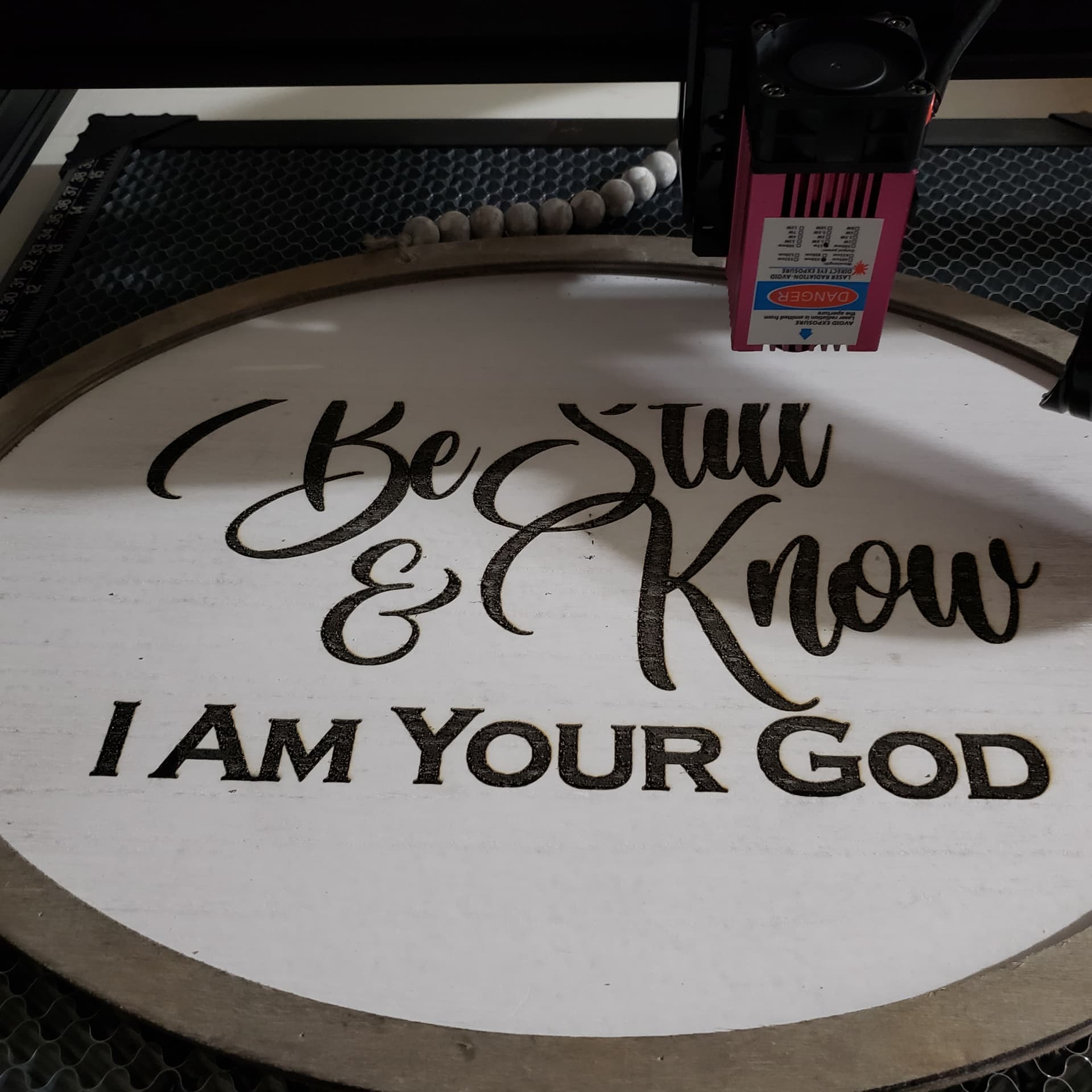

I simply turned off a ceiling fan on the same circuit tonight (cannot dedicate the laser to its own circuit in my home) and it was enough of a change that the controller knocked offline at 92% completion on a 6 x 12 plaque. Paint me really irritated that we have no way to restart.

I have the Universal Engraver and chose it a few years ago before other entry levels were available like today. It sat in the box for 2 more years due to caring for my elderly mother who passed away in 2020. Finally put it all together in 2022 and it is finicky. But it let’s me learn to troubleshoot and that’s important. At least I now realize that line noise is an issue. That controller went down the moment I turned off the ceiling fan. I live in a nice, large manufactured home with a good sized work space created for me yet the electrical is chained and I can only perform certain hobbies - ONE at a time.
I will look into line noise suppressors today.
I will get an UPS today. I thought about that at 12:30 am this morning when it all crashed. I believe this will be the answer.
