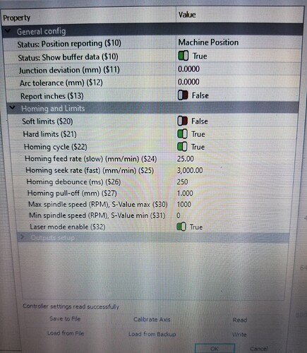

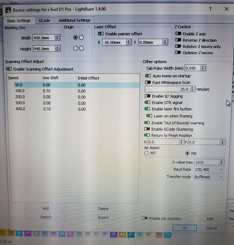

Turn the Xtool off and back on, then try $H in the console window again. Also can you post a screenshot of your device config?

Skreelink - didn’t work. Neither did what Berainlb suggested. I have attached the setting.
I hope this helps.
Thank you.
Disable “Auto-home on start” and “Out of bounds warning”, then turn the machine off, close lightburn, then turn it back on and open lightburn, followed by a homing command. Also, if you’re using absolute coords and repeatable setup, disable pointer offset at the top.
