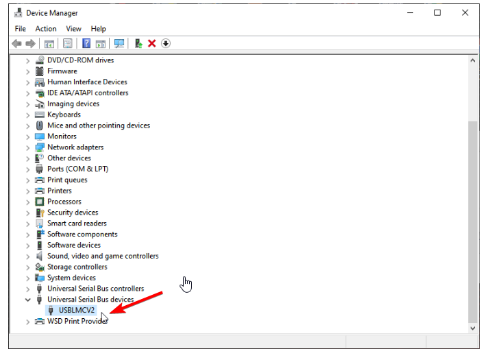

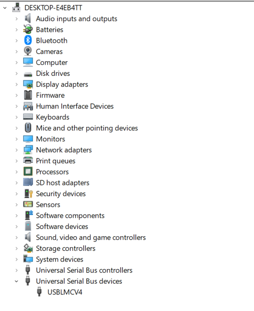

Question - Can you confirm that your LightBurn Galvo Drivers are present?
Right Click windows menu > Device manager
Plug Laser and power it on.
What do you see here?
If you dont see the USBLMCV2 (or 4) it means you might need to install the LightBurn Drivers again.
The installer for the driver is in the LightBurn files at "C:\Program Files\LightBurn\EzCad2Driver" and can be run again via the “dpinst-x64.exe” file directly.
If it wont work, you can try Zadig.
If EZCad connects and Lightburn doesn’t you have the wrong driver installed. They are not compatible.
