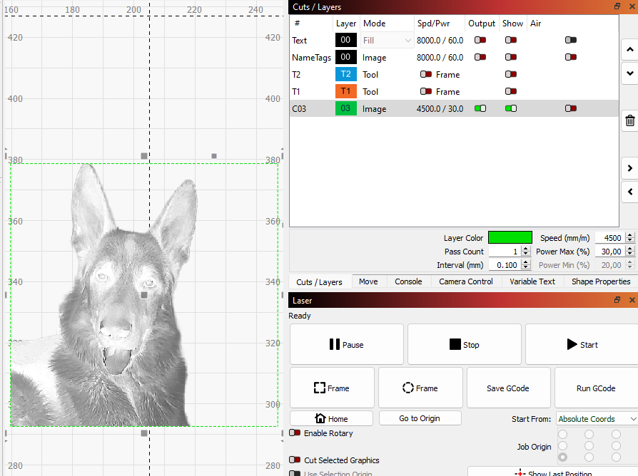

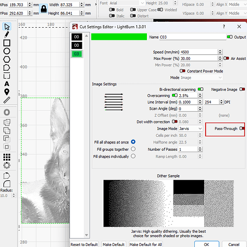

Hello,
dos anybody have problem with Pass-through option in lightburn.

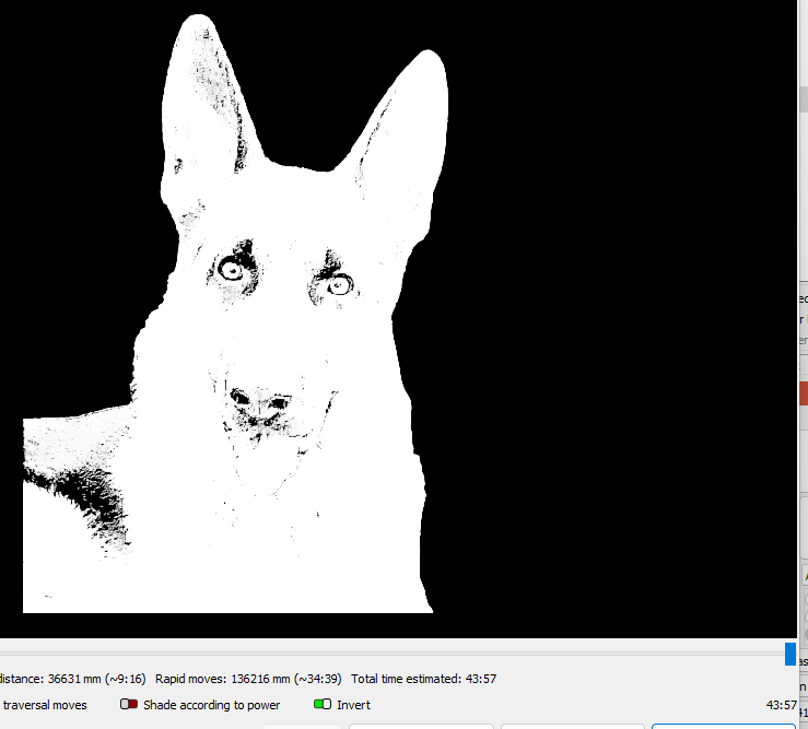

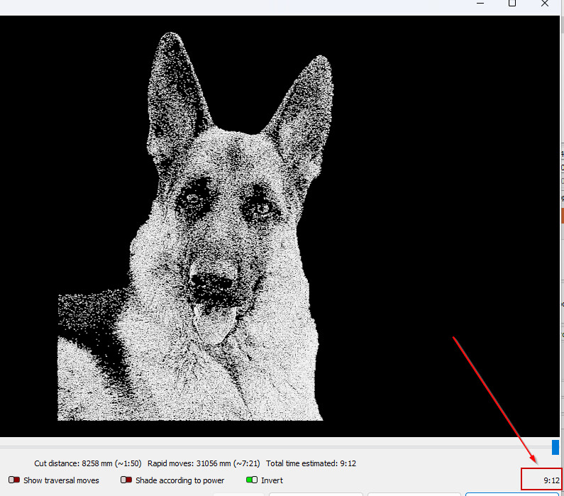

Normaly when i adjust a image in lightburn the image burntime is
say 9 minutes
when i use the Pass-through option the burntime is 44 minutes ?
and the laser speed is incredible slow

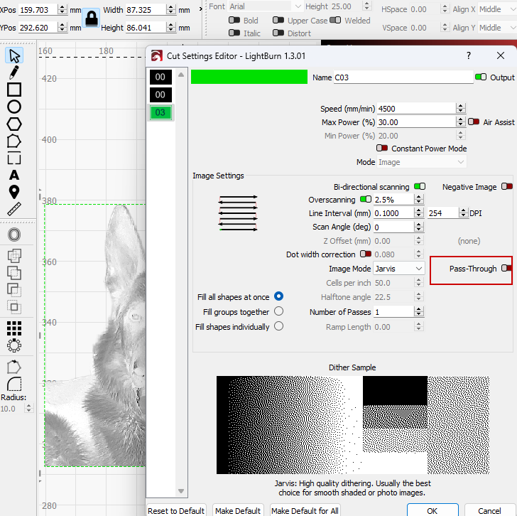

i mate the photo in gimp , greyscaled it
import it to imag-R.com and rezised it to 254dpi
import it again and selected the norton black slate.

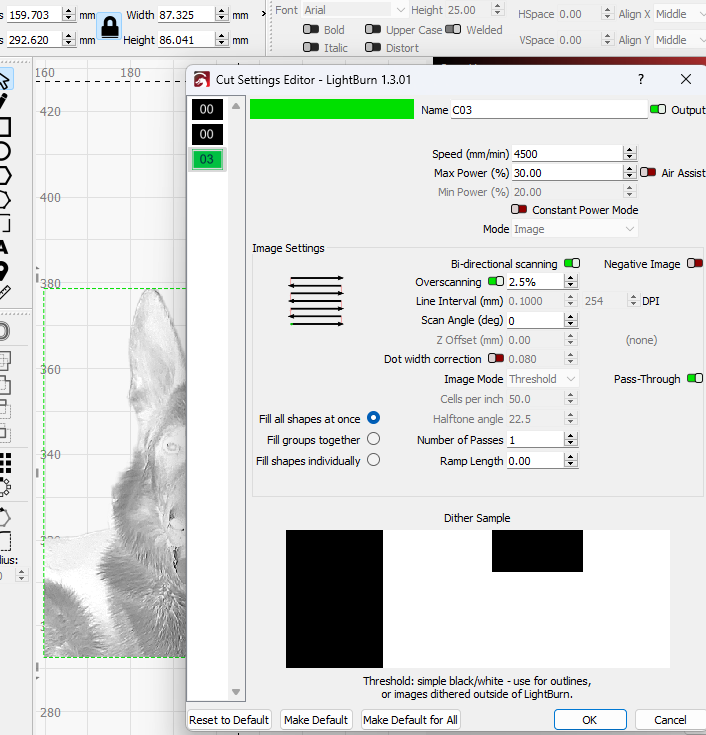

opent in lightburn en selected the Pass-through option
image layer speed = 4500/30
But looks that LB is ignoring the speed.
Setting with Pass-through OFF
WHat is happening here ?
Regards
Any body having this problem to ?
Did you resize the image after bringing it into LightBurn? If you’re using pass-through it means LightBurn sends every pixel in the image as is, with no internal processing at all.
If you have pass-through off, it means that LightBurn will resize the image to the output size and DPI you’ve chosen, and dither it at that resolution.
If you have pass-through on and you took an image that was 8x10" at 254 DPI, and resized it down to 4x5", the DPI would double because LightBurn is still sending every pixel.
Doubling the DPI would also mean doubling the number of lines to process, taking twice as long as an image that size normally would.

Why is the laser speed not the same speed then.
The laser speed should be the same on both options.
Or perhaps just alittle bit slower i quess
But Without pass-through the speed looks ok
With pass-through suddenly the speed looks like its moving 100 time slower.then the setting in the layer.
If you are using pass through, making the image smaller after dithering it increases the DPI, and the number of GCode commands to be processed. If you made it small enough, you’ll basically choke the controller because it’s unable to process the code fast enough.
This is quite common, and one of the reasons we recommend people use the image processing built in to LightBurn, instead of apps like ImagR. It’s much easier to resize and adjust within LightBurn itself than constantly going back and forth to a website, uploading, changing, downloading, importing, over and over again.
