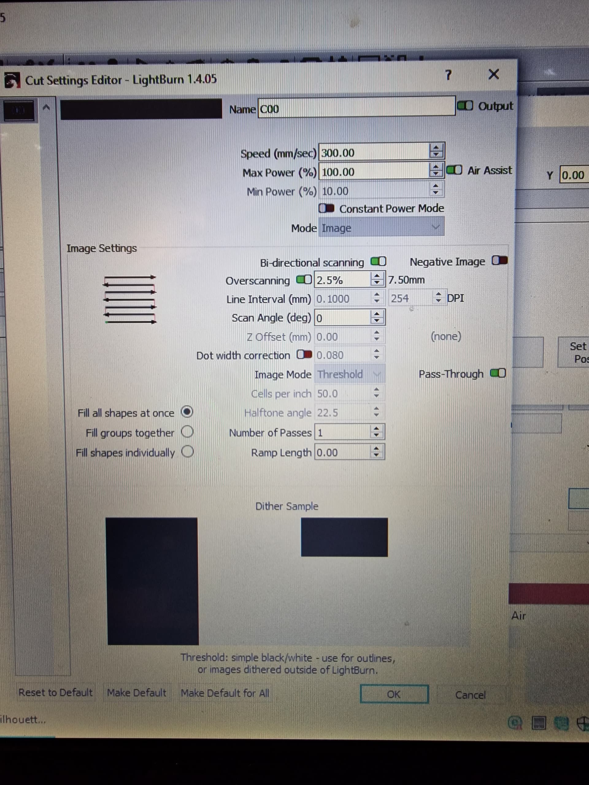

Lightburn 1.4.05 grey min power button
Hello guys, Im totaly new here and its my first time with lightburn and laser engraver. I try to make something step by step from yt movies, but my min power button is still greyed. Can somebody help me please?
Grbl, longer ray5 20w
Minimum power for G code machines is only active when using ‘Grayscale’ image mode.

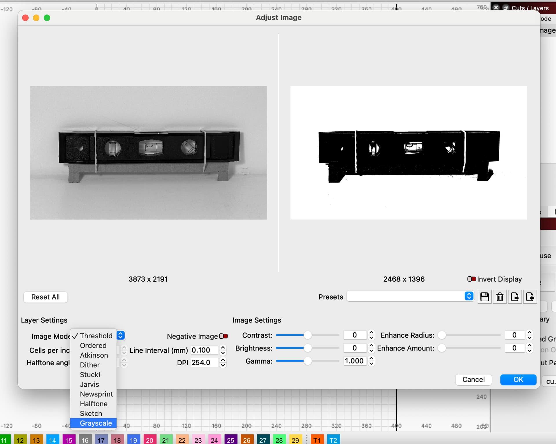

One way is to…
  • Select the image
  • Right-click on the image
  • Select Adjust Image
There you’ll find a drop-down for Image Mode. Choose grayscale from that list to enable the minimum power. The darkness of the image will determine the laser output power.
You may also want to experiment with different dither methods to see what looks best to you on your material with your laser.

You should be able to set the image dither in the cut/layer edit window… Double click on the layer in the cut/layer window.
