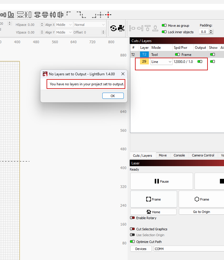

Just installed LB 1.4 and immediately a bug on a simple option?
Error: You have no layers in your project set to output
But i did, see prntscreen the yellow layer (layer 29)
has set output
Tested all layers, No layer is working.
Even rubberband framing isnt working
rebooting / reinstalling not working.
Any idea…

Setting menu, ignore out of bound shapes …?

In the Cut Settings Editor for that layer, is the Output toggle in the upper-right corner turned on?

I think Jack meant this setting:
Under the gear icon in the top toolbar.

Output was on
out of bound was not the problem, when i put the selection off grid it saying out of bound
Found the solution for my problem.
Seems that 1.4 had corrupted my wast-grid file
copy past all in a new file and save it under different name.
Now it seems to work again.
i always open LB with a file that already include my wast-grid so i have my wast-grid bij default and save that file to whatever im buissy with.
