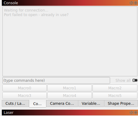

  1. Is the console available to me? I have the console tab, but it doesn’t look like I can interact with it. I saw somewhere about it not being available to ezcad hardware and I assume that’s what I have and why I can’t interact with it.

Without knowing your machine, if you can interact with it in LightBurn, i.e. you can operate it in some way, then it is also “installed” in LightBurn. Depending on the machine’s controller, there will be activity in the console (not if it is a DSP controlled machine).

There is a console on grbl type machines, but not on a fiber machine.

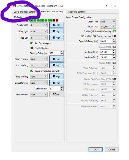

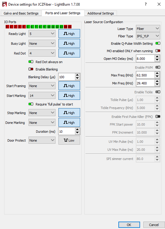

Post the machine settings screenshot. Like to see if anything was imported.

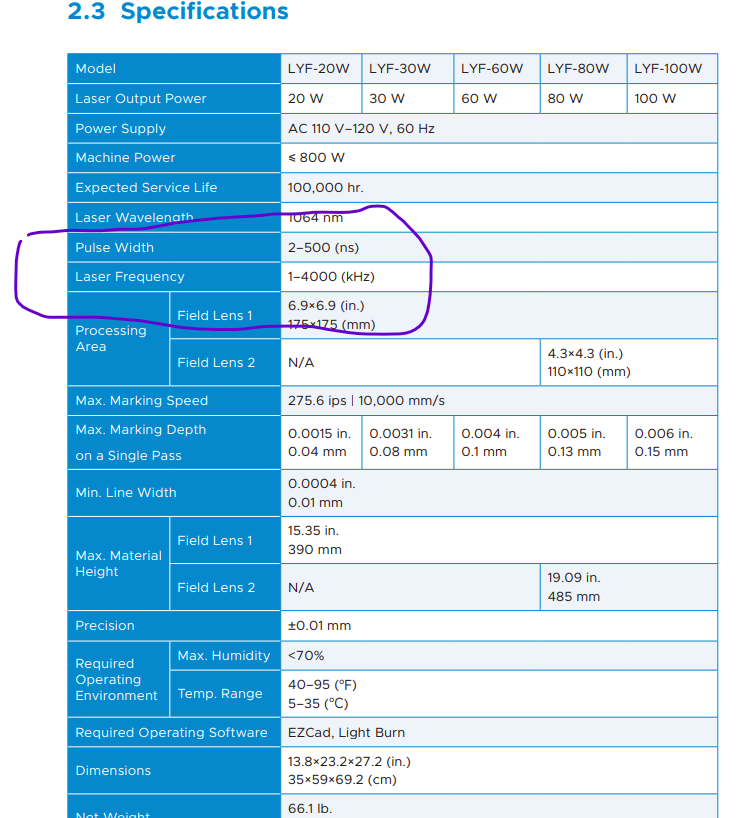

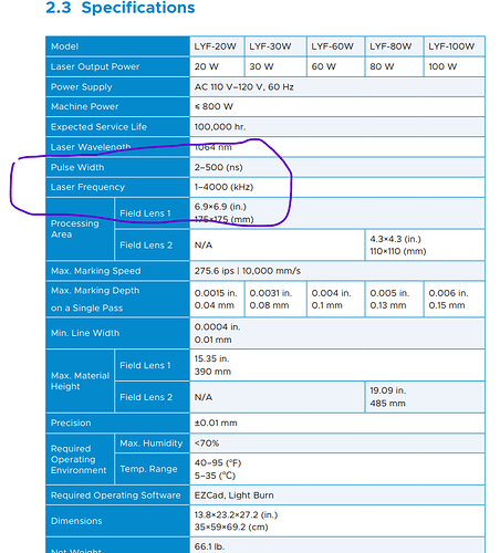

I went through the whole product manual, maybe missed it but I didn’t see laser source, although suggests JPT MOPA as the Q-pulse and Frequency are 1-500, 1-4000 which is typical for a JPT MOPA. Your frequency on the screenshot is 29-62 so something is messed up. If it was me, FIRST I would 100% confirm focus. Start with the lens near the top of the column, run a repeating pattern, 100% power and slowly lower the laser down looking for the laser to burn and make the most amount of noise. Use aluminum or SS for good results. If you already did this…

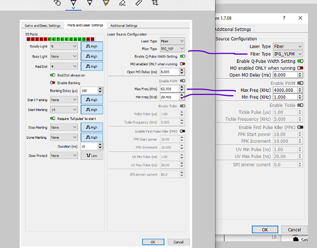

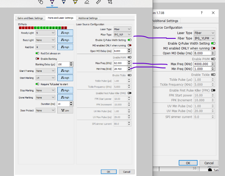

I would try IPG-YLPM or JPT in laser type, not IPG-YLP. Need to power cycle after making changes to laser type.

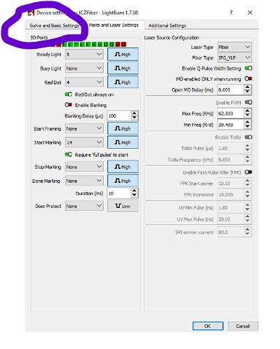

Is the screenshot I posted previously the machine settings you mentioned?
I did run the previous test and got no results. This time I tried changing the settings to what you suggested for between 1 and 4000 KHz frequencies. I tried switching between IPG-YLPM and JPT (with power cycling) and still got no results.

The console is for grbl or other controllers that accept commands and controls, generally over the USB connection.
You can enable the console, even if it’s connected, it has no one to talk to with a Ruida or a JCZ controller.
Console when connect to the JCZ or the Ruida control board.
Wow. In 3 years of using LB with the Fiber Laser I never enabled that window until now. What commands or macros could you give the BJJCZ board?
:smiling_face_with_sunglasses:
Those windows are set by default to not show, and they are not relevant for the DSP and Galvo control systems. :slight_smile:
