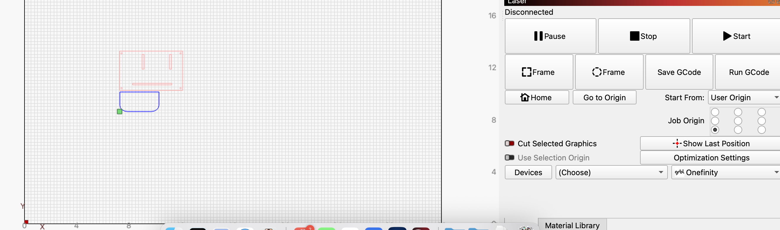

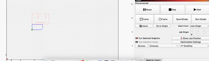

I upgraded from 1.7.08 to 2.0.00 and now when I save GCode the generated file contains a move at the end of the file to the absolute origin even when I’m using User origin. For example, comparing the GCode generated from 1.7.08 to 2.0.00, I see the one additional move line:
# diff User\ Origin\ v1.7.08.gc User\ Origin\ v2.0.00.gc
1c1
< ; LightBurn 1.7.08
> ; LightBurn Core 2.0.00
426a427

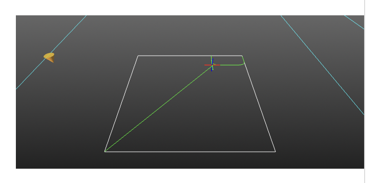

> G1 X-7.2845Y-8.6117S0
Is there a new option in 2.0 that I need to disable? The move to the absolute origin causes my laser to go out of bounds. I can delete the extra G1 line from the generated file and things are good, but I can’t figure out why that line is being generated now. The origin settings look identical between versions.

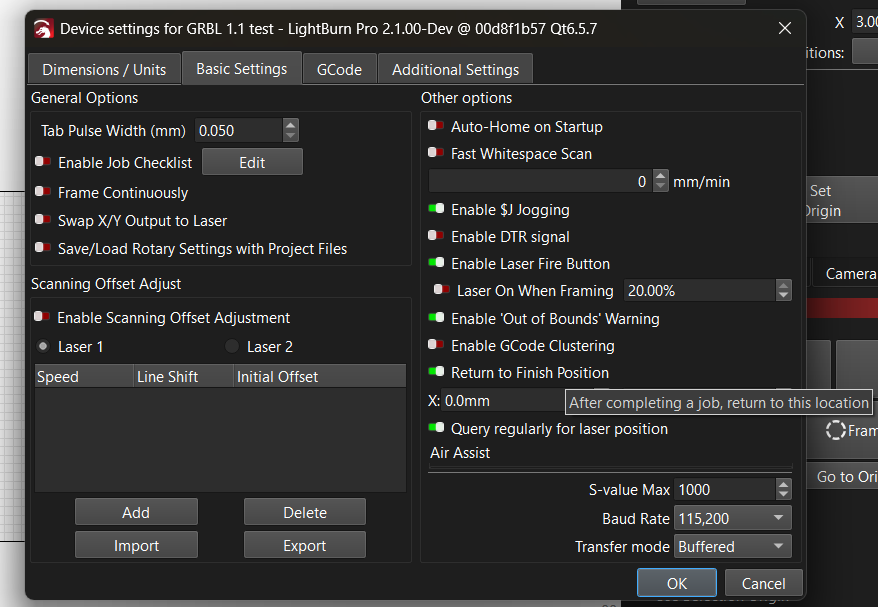

Do you have a value set / or the toggle enabled for Return to Finish Position in the device settings?
Thanks for looking into it. I don’t have Lightburn directly connected to my machine but I simply export the gcode and upload it to the machine manually. So I think that means the offsets don’t apply but maybe I’m misunderstanding your question.
My first thought was the “Return to Finish Position” option but I’m pretty sure I had that enabled in v1.7 without issue. I’ve tried it enabled and disabled in 2.0 but it doesn’t seem to make a difference. It always generates the move to the absolute origin even when using user origin in the exported gcode.
