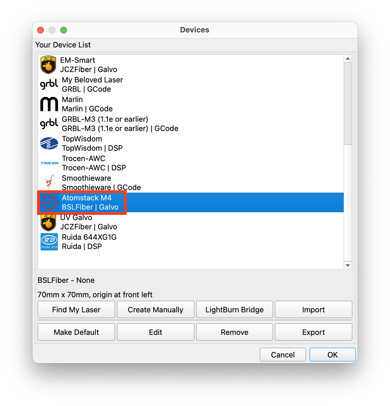

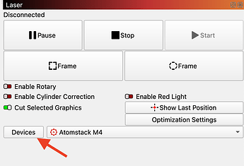

To check whether this issue affects your laser, click the Devices button in the Laser Window and check the device type in the list — only devices marked BSLFiber are affected.
Example hardware: Mr.Carve M1, GWeike G2, Atomstack M4, some Monport galvos, Atomstack M4.
