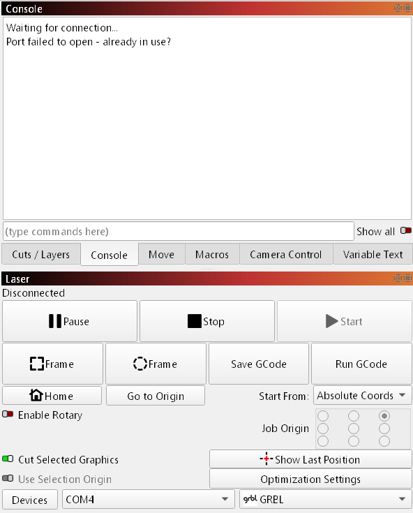

Lightburn 2.0.04 not Communicating with Controller
Manually setting up GRBL device (Creallity Laser 10W). Lightburn doesn’t detect any COM port.
The controller board chip has Espressif ESP32-S2-MINI-1.
V2.2.S2.113 is printed on the board, I see V2.2.S2.113.
Win10 Device Manager “sees” the USB connection to the controller: When I plug in the USB cable in the back of the computer, “USB Serial Device (COM3)” appears and when I unplug the cable, that port disappears.
Are you saying Win10 device manager shows COM3 when the laser is connected, but Lightburn is not showing COM3 as a choice?
Correct. Win10 device manager shows COM3 when the laser is connected, but Lightburn is not showing COM3 as a choice.

Hmmm. Just playing around, I viewed “Hidden Devices” and uninstalled and deleted drivers for the Silicon Labs com driver (which had a yellow triangle on it anyway).
Then, when the standard USB serial driver came up, I changed it from COM3 to COM4.
When I went to Lightburn, COM4 showed up with the GRBL device, however, the CONTROL window said that the port was in use by another device.
I wonder if this helps me along in troubleshooting efforts?
Not sure how to respond to that. A.I. typically has a 30% accuracy rate with 100% confidence. I guess only you can verify the validity of the returned text. Did you search the Forum for USB and Creality for possible information?
I seem to be saying this too much lately, but you might email Support@LightburnSoftware.com with a link to this thread. They have a wealth of information and machines to call upon.
