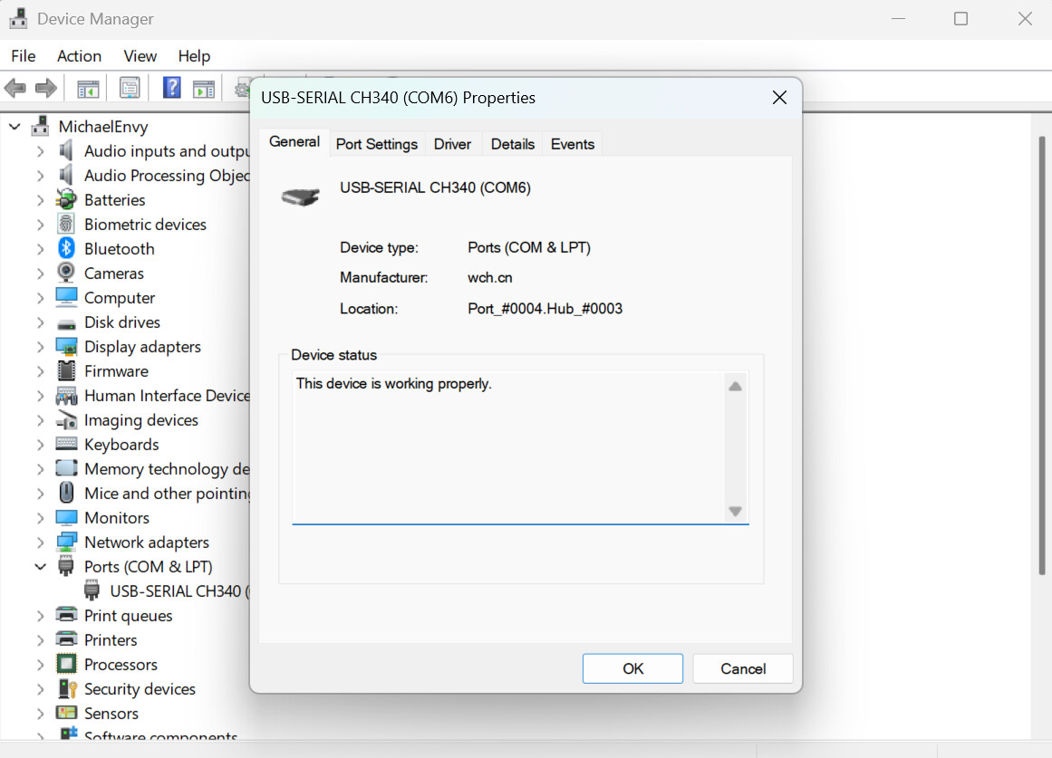

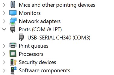

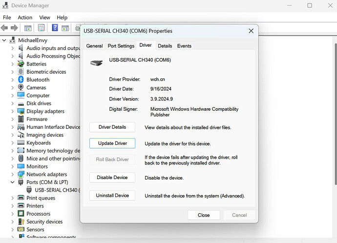

Win11:
Start icon
Right click
Device Manager
Ports (COM & LPT)
Screen capture (WinKey+S) what it says. Save the image and then attach it to your Reply.
Mine looks like this…
I am starting from a clean boot - nothing running. I am not running any other laser software.

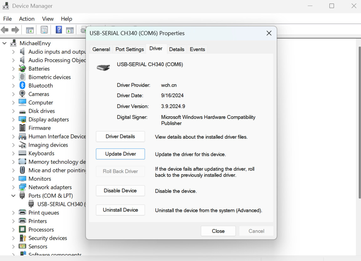

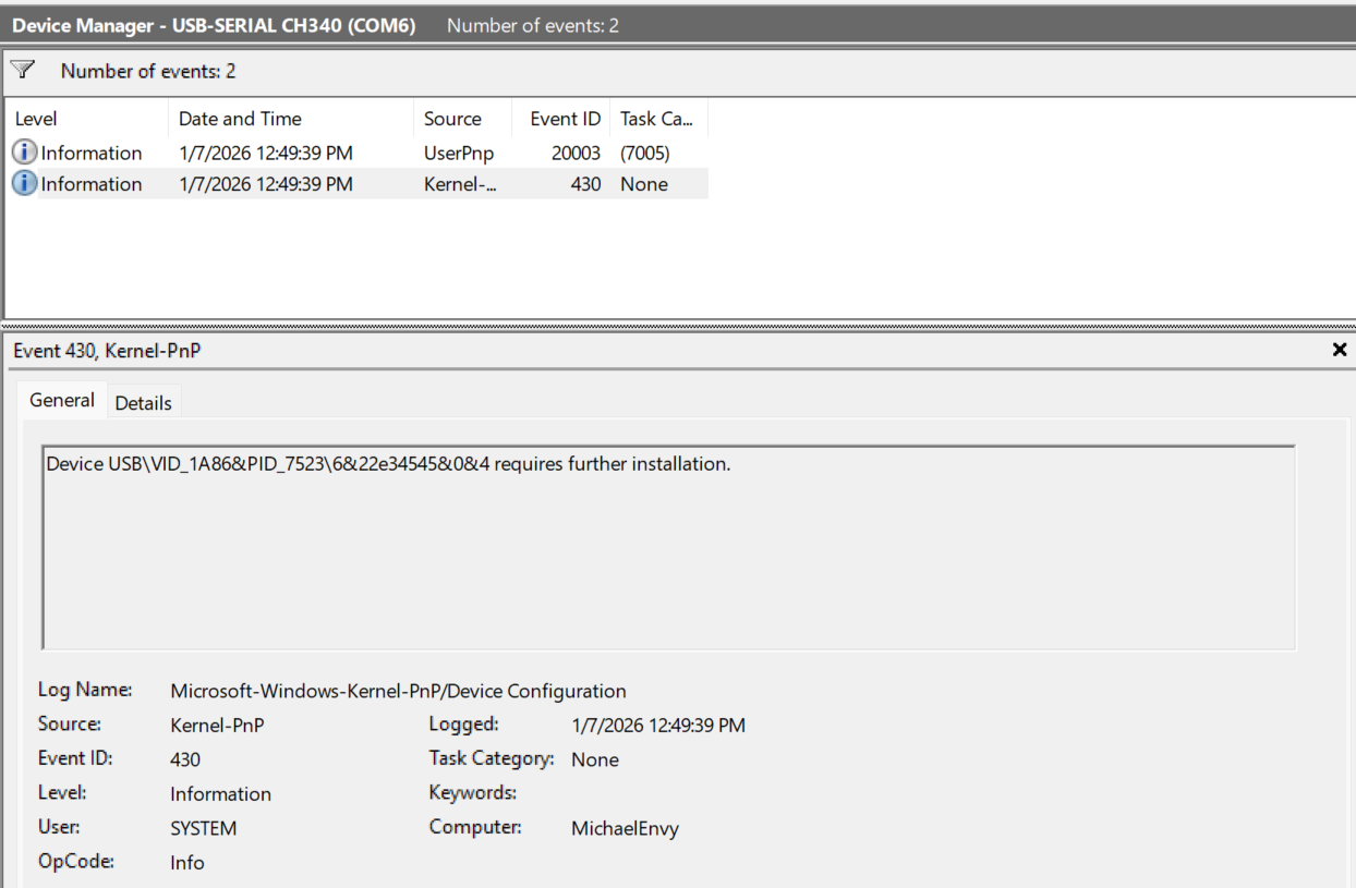

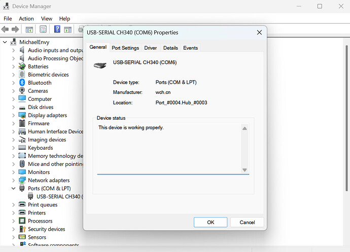

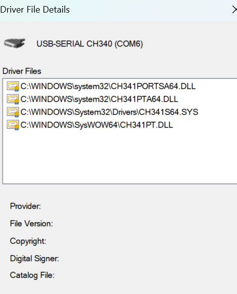

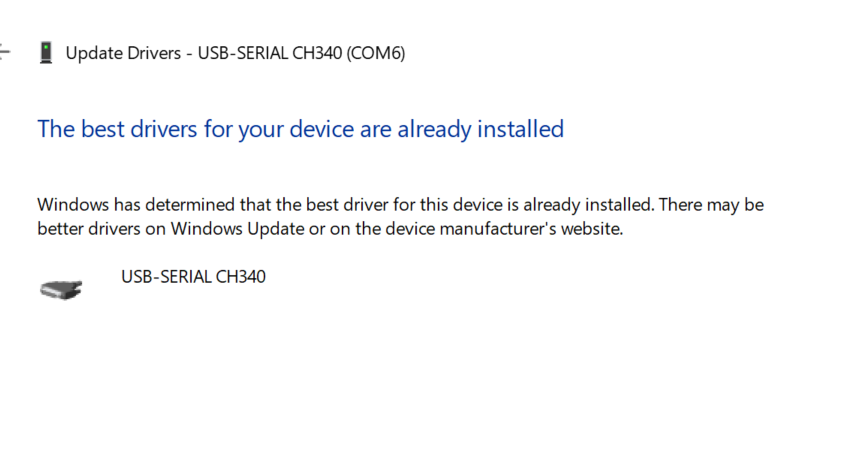

Here are a couple of screenshots that I hope are helpful. One indicates requiring further installation, but then the computer says that I have the most up to date version. ???
Thanks for your interest in my issues.
The USB drivers appear to be intact.

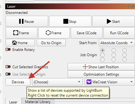

If it still comes back as “Busy”, try a right click on the “Devices” button in the laser window here to reset the current connection

Solution: Right click the Devices button TWICE to reset the current connection.
It’s needed twice, because eventually it’s capturing an OK response from another command ($I, or $H, if “Auto-Home at Startup” is enabled. → $H sends back two OK messages!, again, not how standard GRBL firmware is supposed to work)
