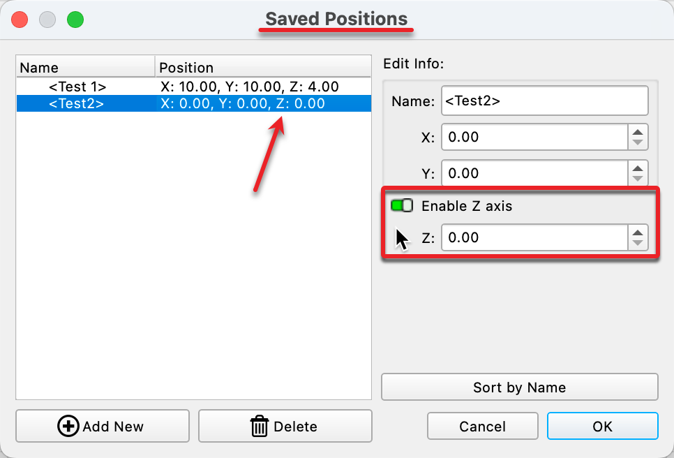

In the Move window - one can get the X and Y and Z and U positions. And make a change to X and or Y position, and then GO to that position.
Is there a reason that there is no option to adjust the Z value.
As after a focus - I often have a need to De Focus the laser for some jobs - and doing a manual move is often fraught with USER issues (I often have the shakes) and trying to make minor focus adjustments is rather Hit and Miss.
Thus along with Engrave/Focus and Cutting depth Macros - I have another 4 Macros on my Main system to set different Off set values.
Thanks in Advance
One option, use Saved Positions in the Move panel, then select that when you want to defocus. :slight_smile:
