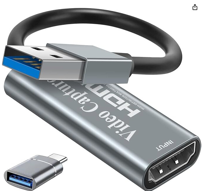

I’ve now found an unconventional workaround. I use VLC to send the camera image to an HDMI-USB dongle that Lightburn recognizes.
So, VLC → graphics card → HDMI → USB → PC
Unconventional, but it works for now.
grafik
Interesting yet unconventional! So this works with IP-camera feed that you capture with VLC? What kind of HDMI-USB -dongle do you use?
I work with three monitors on an Nvidia RTX 4070 graphics card, so I have one free port into which I plug the HDMI - USB dongle, which then goes into the PC. Then I clone ports 3 and 4 of the graphics card and open VLC on monitor 3 (4), open the network stream, and run VLC in full screen. Done. Here some pictures:
