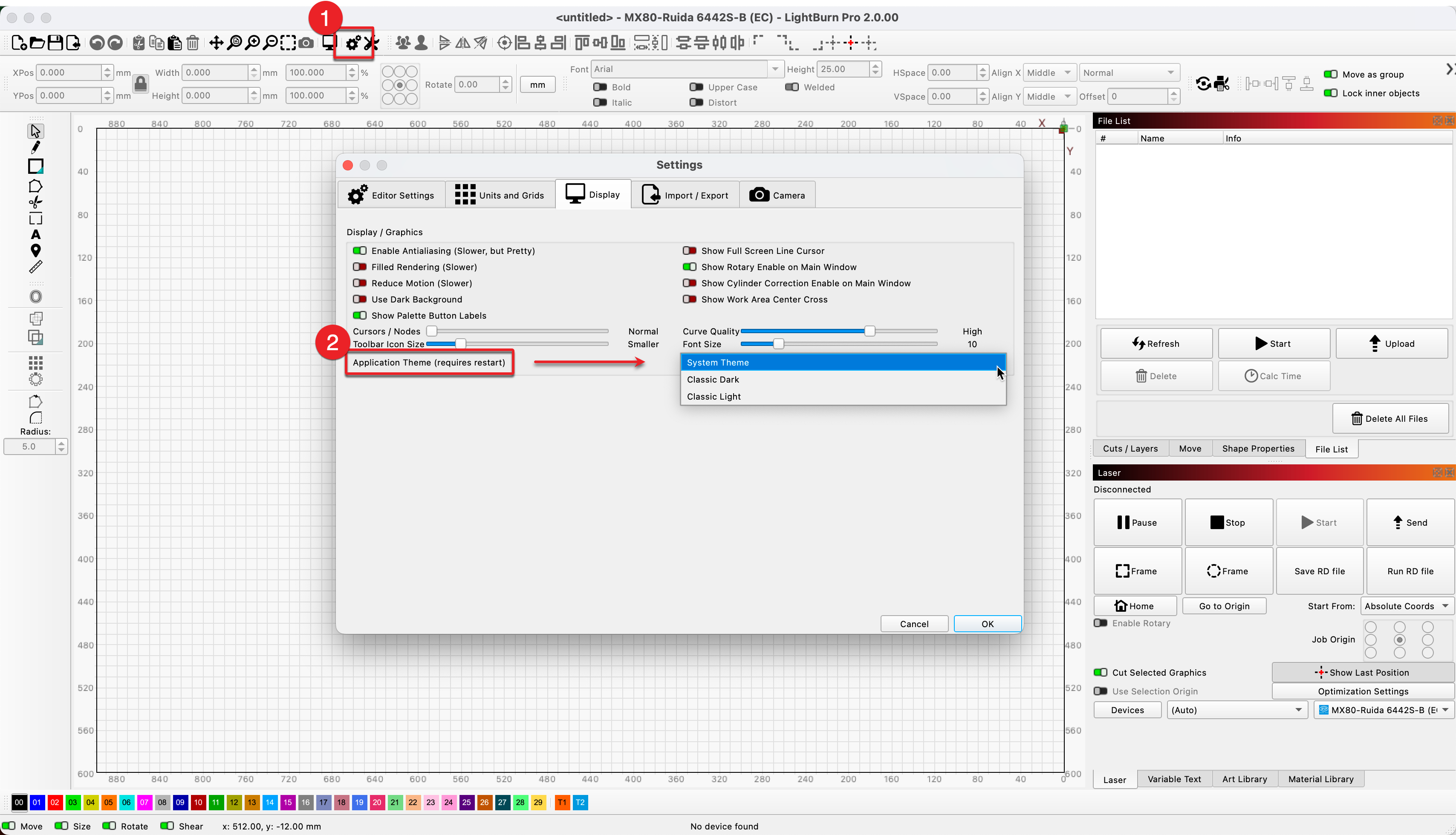

You can set or change as follows:
Yes, as revealed in the Release Announcement, our Blog and the Change Log presented when updating, Dark Mode is a new feature with the 2.0.00 release. You can read some more about the details here:
Dark Mode
You can now select from three Application Themes in the Display tab of the Settings window: System Theme, Classic Dark, and Classic Light. Important note: switching themes requires a restart.
Learn more
