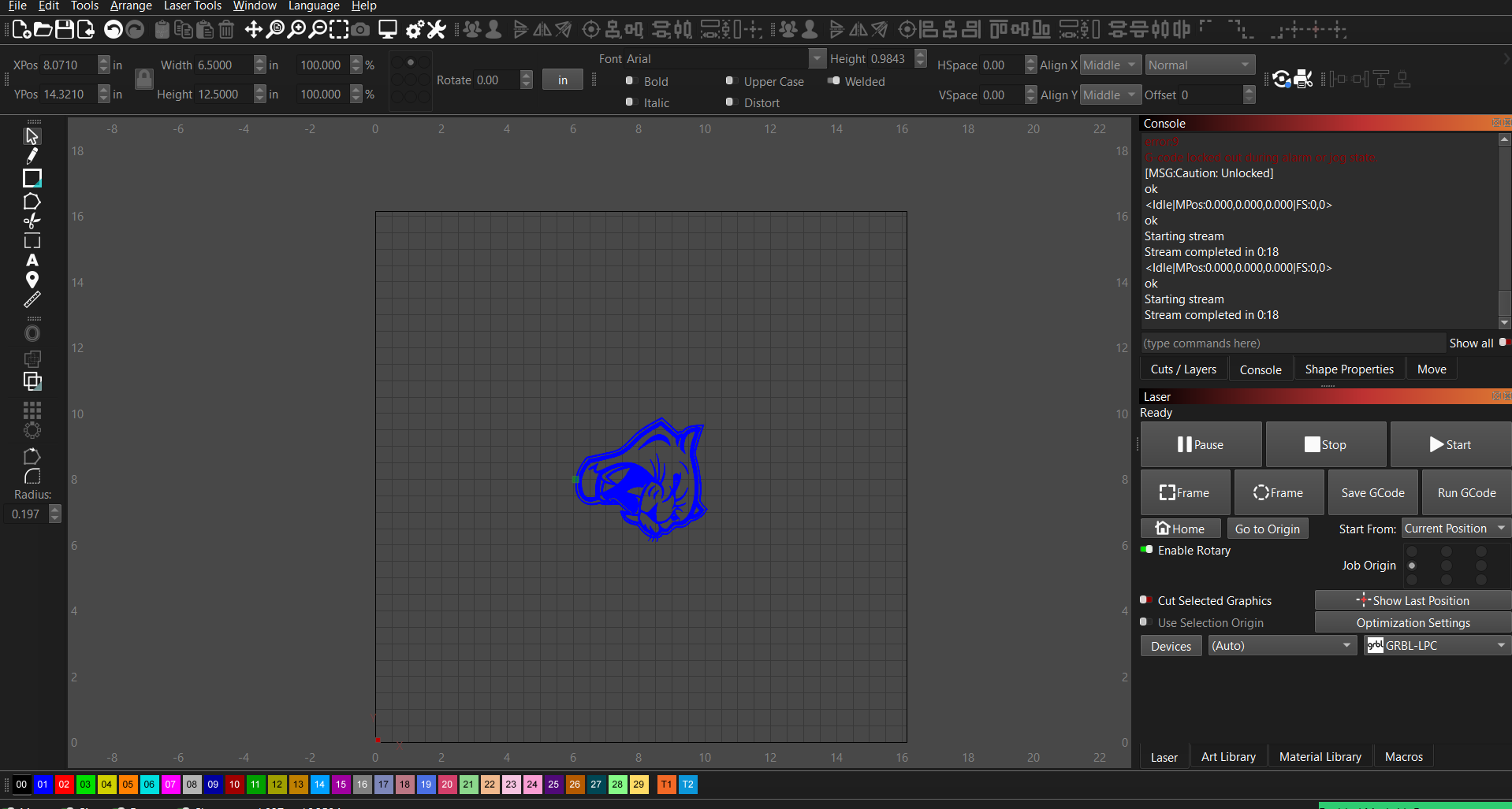

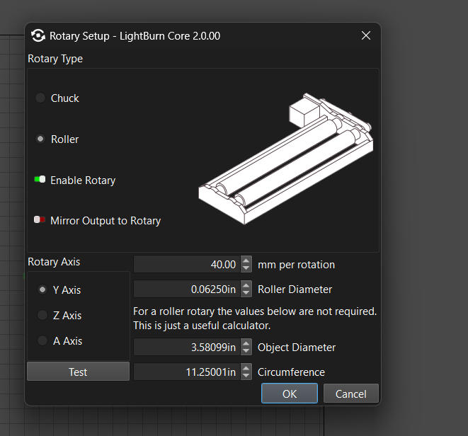

Hi there, I updated to 2.0. really haven’t had any issues until I tried to use my rotary. I’m using an Atezr L2 24watt laser with the atezr roller. I have it set correctly in lightburn and click enable rotary, but when I go to frame it is doing several complete rotations. I do have videos and pictures. I guess I can’t put the video here. if I disable rotary it seems to frame as i’d expect it to but the rotary is disabled. I might be missing something stupid but I’ve never had this issue until 2.0. thanks for the help!
I have the Atezr roller and the roller diameter on mine is about 0.625", not 0.0625 shown in your image.
Ah crap. That will probably be it. I knew it was going to be something stupid. I have .625 wrote down in notes. Also have a chuck so thats why the number even got changed today. I’m not by the laser anymore today but ill fix that and update if that took care of it. Thank you
You and I are both members of a very large ID10T club. :nerd_face: :joy:
9 times out of 10 its operator error and just not paying close enough attention to detail. That .625 did fix my issue. Thank you
