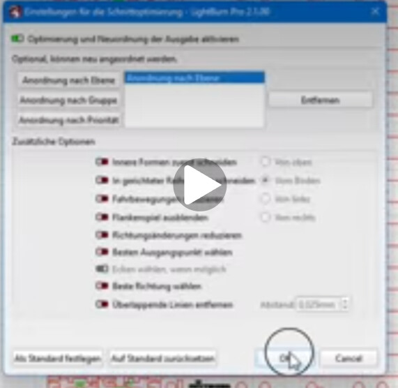

Since I switched to Lightburn 2.1, the optimization settings and the results they produce have been completely messed up.
What used to generate a reasonable cut path in 2.0.05 now cuts wildly across the surface, see video:
Is this a known issue? Is there a workaround? Is this being addressed?

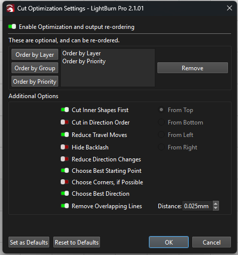

Did you compare estimated run times between the two versions?
Why do you not have “reduce travel moves” enabled? Without that, the software will not attempt to reduce the amount of travel between shapes.
It’s the 3rd toggle.
Take a look at the videos, I show them.
That doesn’t produce the desired result either; while the cutting time is reduced, the cuts are still erratic.
I’ve designed my cutting files to cut from bottom to top to prevent incorrect joints when the material expands. Why is the optimization feature intervening here, even though no such option has been selected? The “optimization” is only active to group the output by layers.

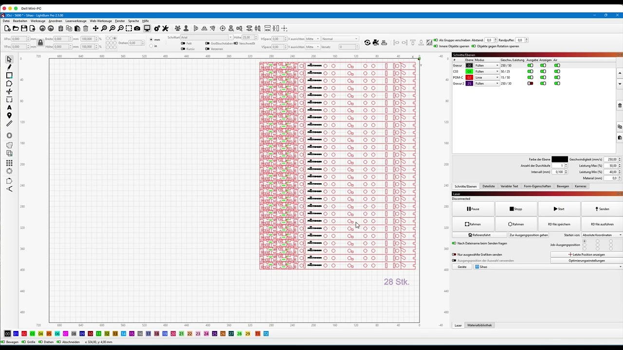

Here’s another video: without optimization, it cuts exactly as I saved it in the file. As soon as I enable optimization “by layer,” everything gets completely jumbled up:
I just don’t understand why a feature was “improved” in a way that broke it.

It’s barely visible but it’s the 3rd one down
Most of the settings appear to be off.
As to why - I’m not sure. If you provide us with the file I’m happy to take a closer look.

If you enable any of the optimizations, the shapes ordering is no longer guaranteed or preserved in any way. The shapes are added to a data structure that allows for fast neighbor lookup, and in doing so, no longer preserves their order in the file. (To be clear, adding that constraint would basically kill the speed gain). That said, by just setting the “layer” constraint, none of the proximity optimization is enabled. I might be able to change it to allow it to work this way, but I can’t promise - that code is exceedingly complex as it is.
If you can attach your project file here I can have a look (or email it to support with a link to this thread).
It is possible to enable bottom-up as a constraint, along with reduced travel moves, and that would likely get you close to what you had. Or you can turn off optimizations completely and just build the file in the order you want it. You can also assign Priority values to the shapes (on the shape properties page) and turn on Order by Priority, which will run them that way - shapes assigned the same priority will be run in the same “set”, and sorted by the other rules you have enabled.
