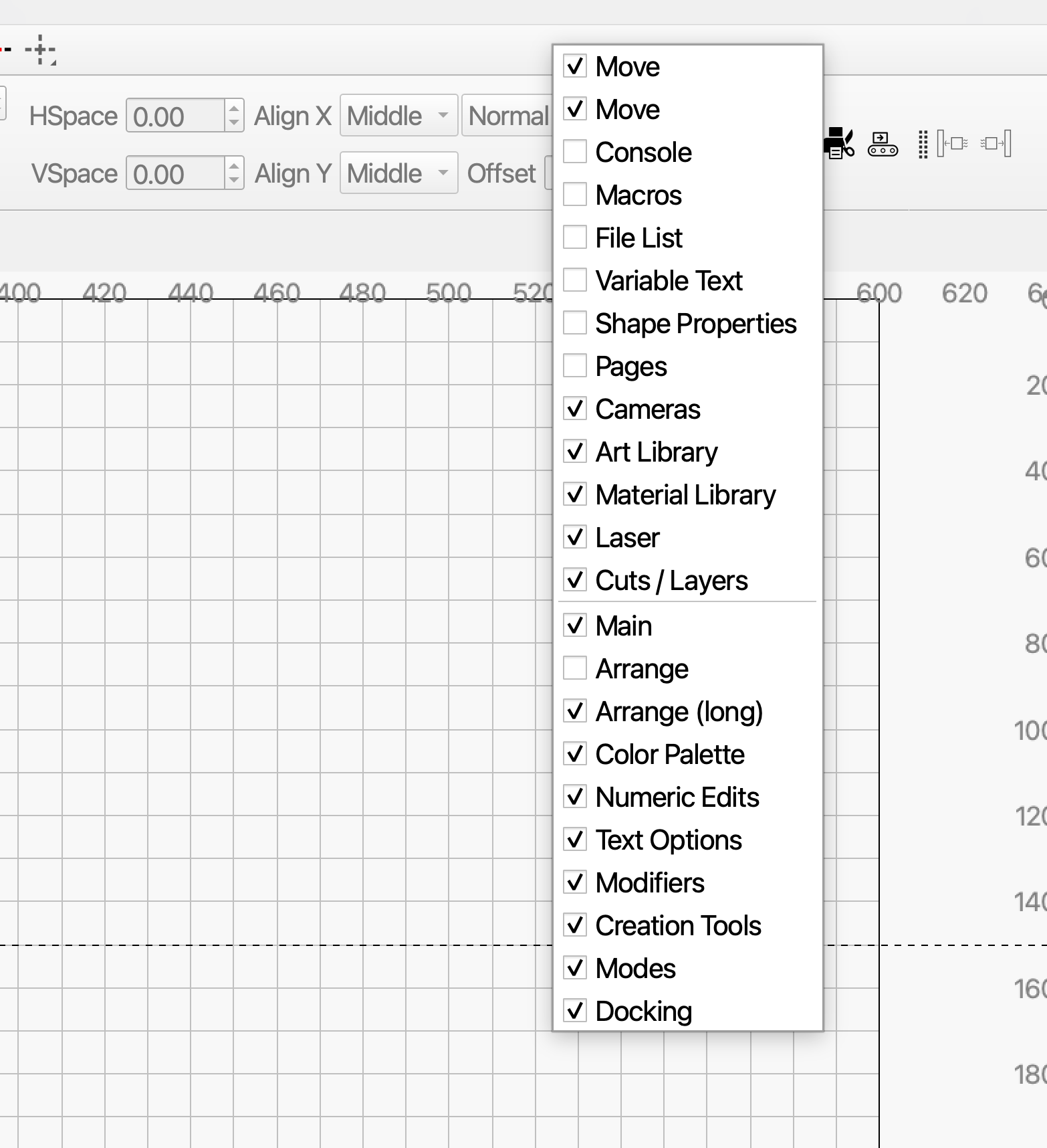

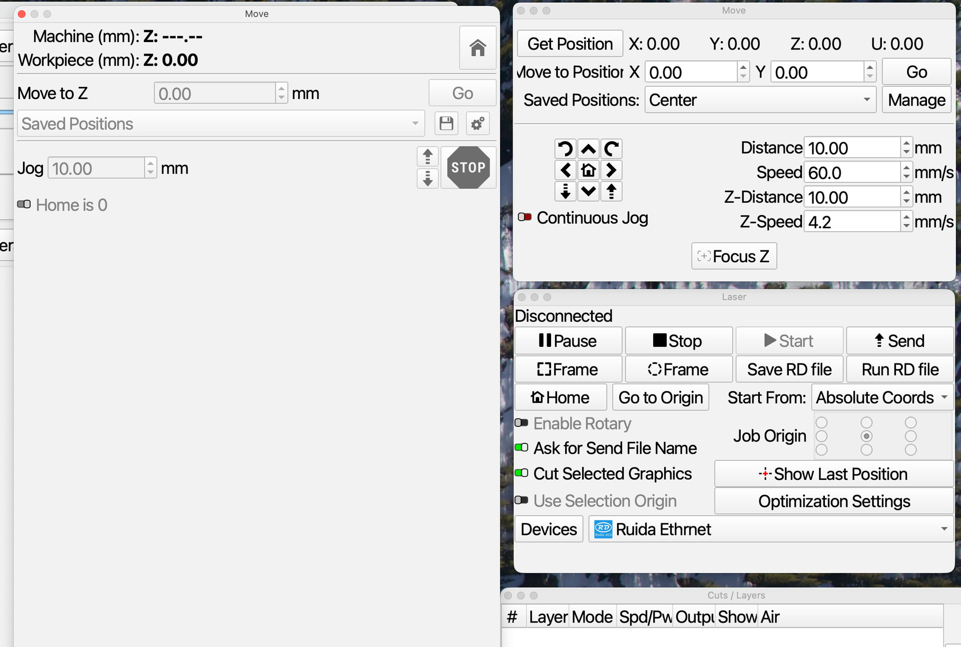

Just opened RC-2. 1st? why 2 “move” boxes?

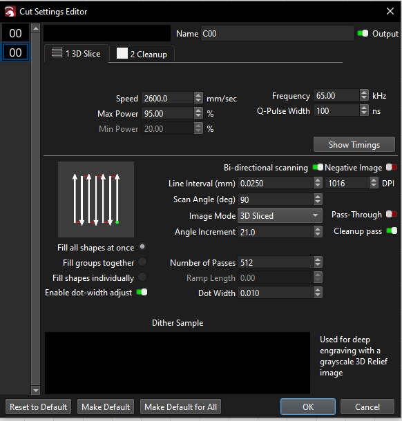

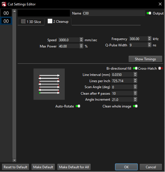

STL File with this settings
but no clean pass after 10 passes, also nope after 50 passes…

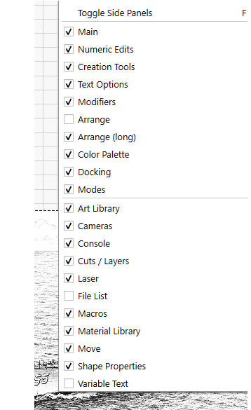

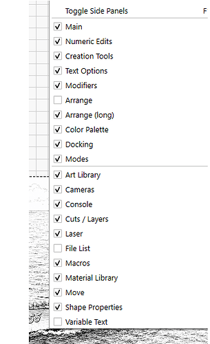

Does not show up like that in Windows.
win10
Adjust the various Snap distances to your preference, Object Snap in particular:
On a 2650×1440 display, I have Object Snap at 10 pixels and Grid Snap at 0.1 mm, which seems to work well enough.

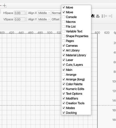

Indeed! I notice your order of entries is different too.
One of them is probably the new Galvo Move window. I only see one on my side. I’ll forward this to investigate.

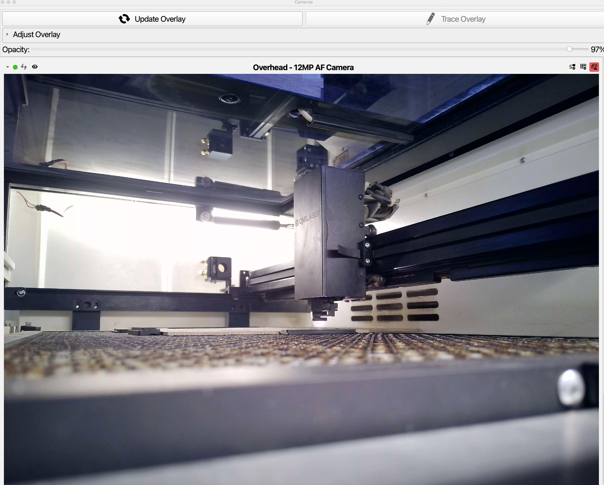

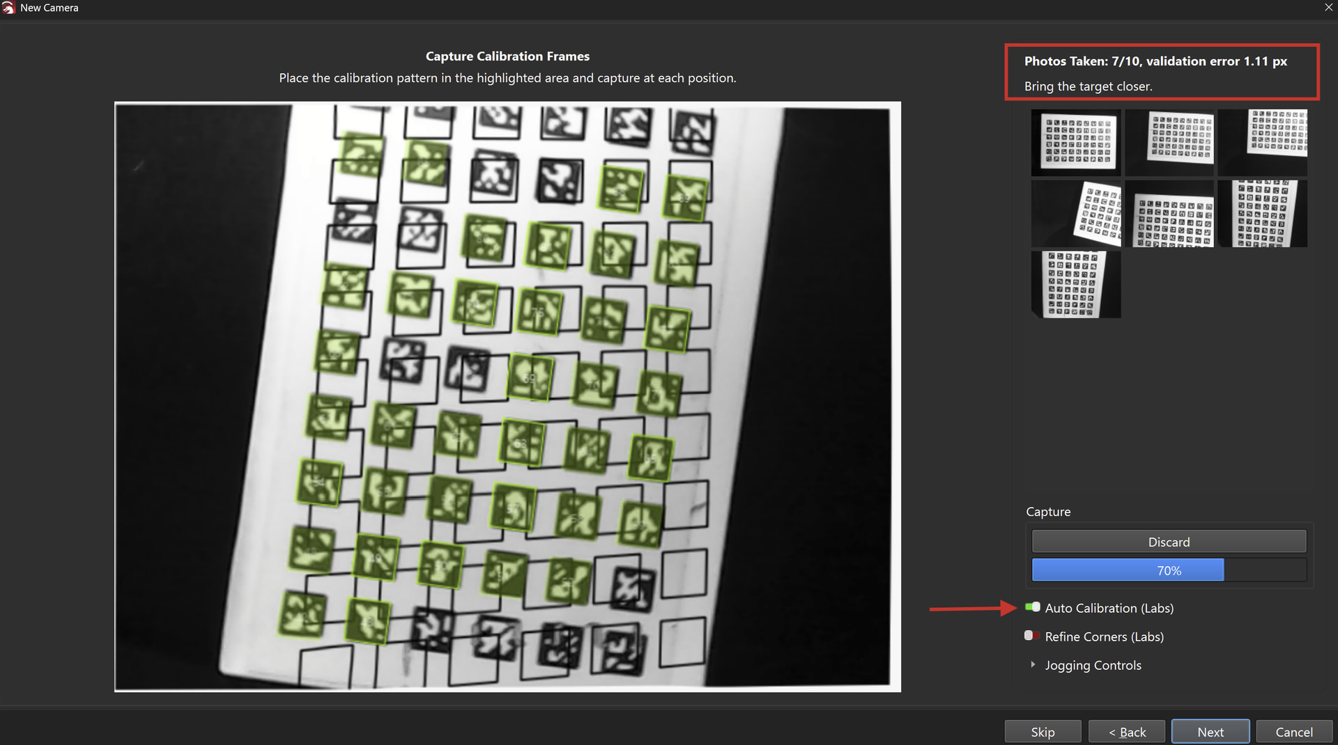

I’m not sure if that depends on the selected device type, but for now this is meant for EZCad3 devices only.
aka “Auto Calibration (Labs)” !
@bernd.dk might enjoy this. :slight_smile:
It’s a new algo that we’re testing.
This way, we don’t need to manually capture the 5 pictures anymore, and we’ll get more samples with the calibration card at different angles.

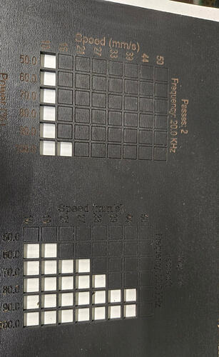

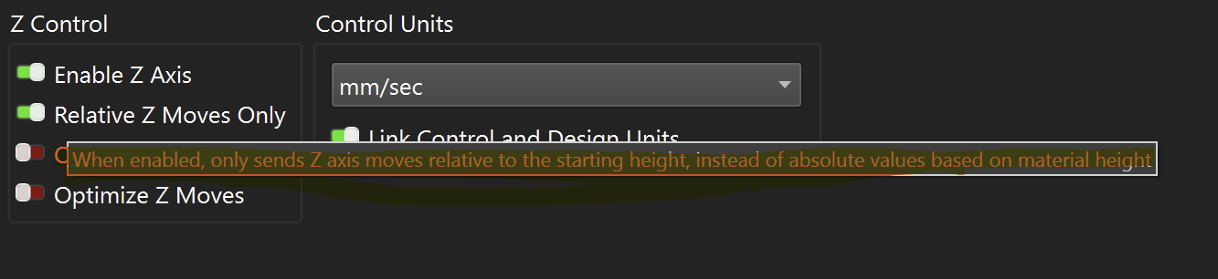

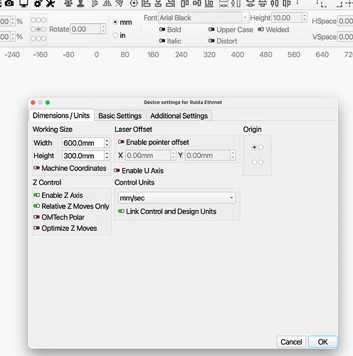

I was using a 1Laser Ruida. while running I noticed the Z actuating between shapes. Never have seen that before. BTW I have documented my RF is not putting out expected power. I am contesting with 1Las about that. getting the runaround so far. I doubt LB has any bearing on it.
Can you tell more details how the Z axis actuated?
Are you using a Z Offset, or Z step per pass" in the Cut Settings?
1Laser’s tutorial here doesn’t cover the necessary Z Axis settings, so it’s unclear if those two features are expected to work, or which exact options are needed in the Device Settings here:
This can have multiple reasons. The most likely one being misalligned mirrors if you ask me.
They have a support doc covering some topics here. (Look for the “Beam Path Missaligned” one.

  1. Yes I was using a Z offset BUT not “per pass” yet the focus is actuating per pass. Issue solved just had never seen it on cam before.

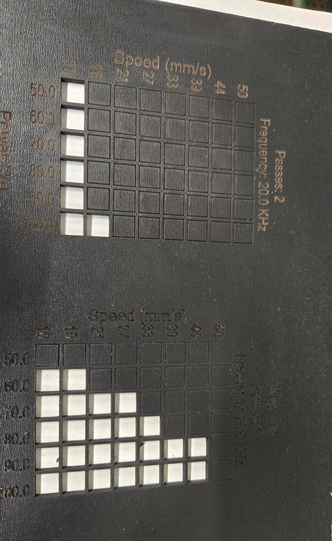

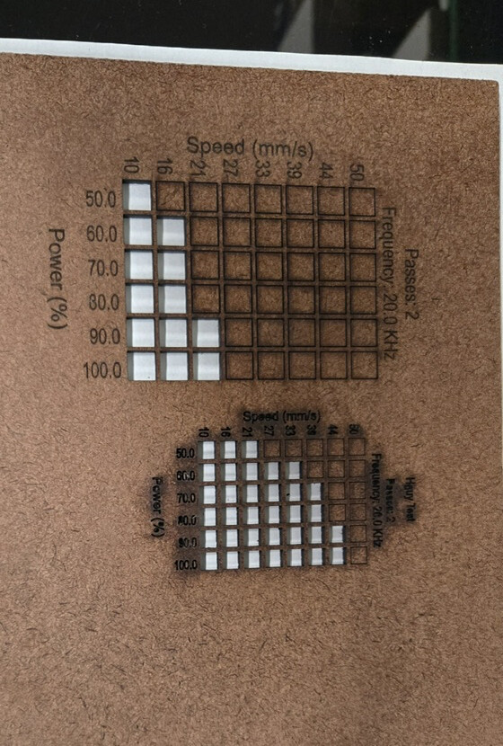

  2. WEAK POWER. I became suspicious of this a while back. I have realigned everything 3 times. Path down through the nozzle is great. Ramp tests have found optimal focus. Fine-tuned the autofocus offset. Then because I had no other XRF to compare too The LA Hobby guy let me send him a material test and he ran the same on his machine. The results are stark. Where to go from here?
How did you solve it?
Turned off the Z Offset, or changed the Device Settings?

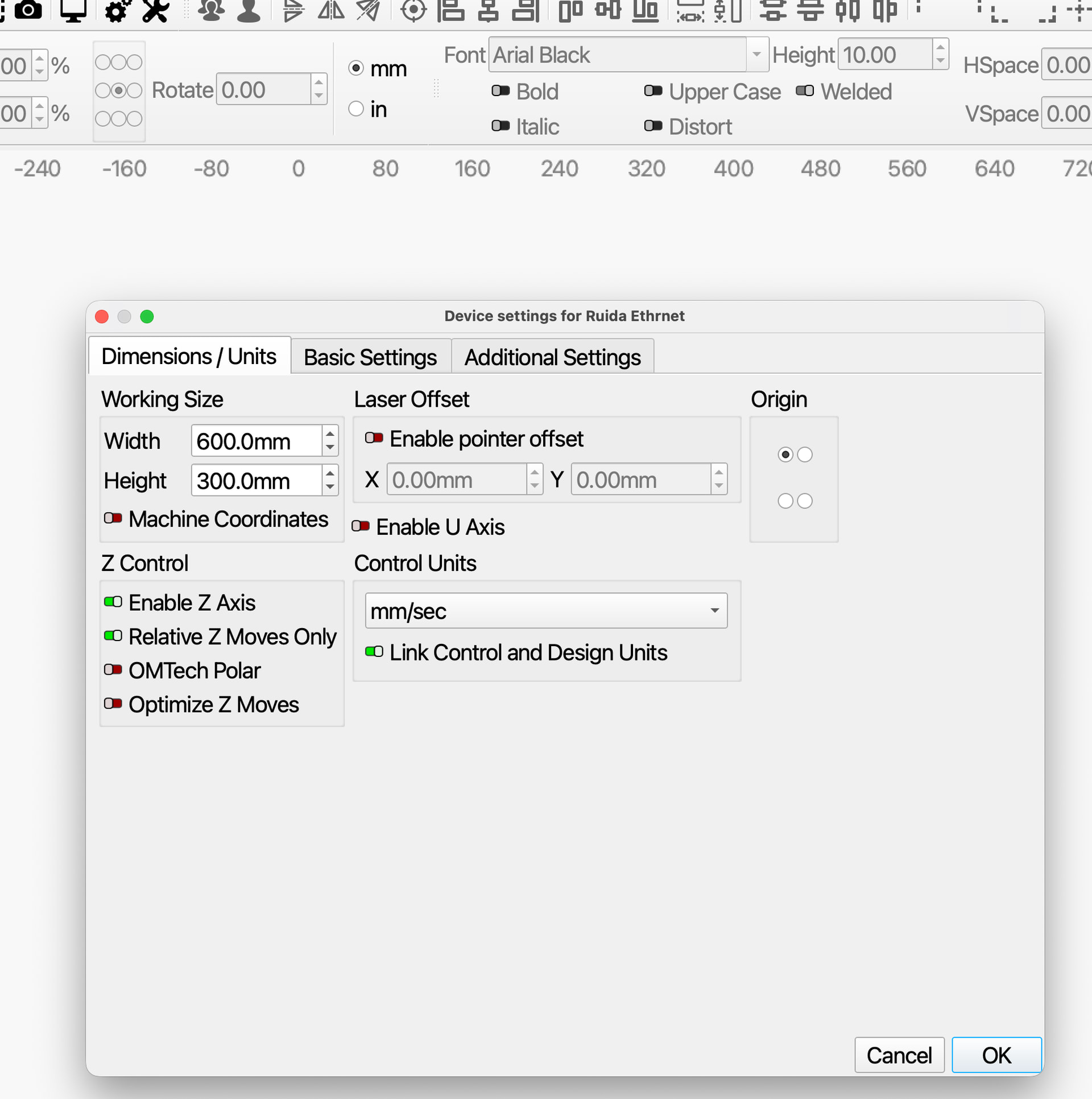

Which options do you havce enabled here?
It sounds like you needed to turn on “Relative Z Moves Only”
If that’s done on the exact same model, and with the same type of MDF, I do see a slightly stronger output in the first picture.
But there are just too many variables for me to take an educated guess, whether your laser source has weaker output, or why this could be.
“solved” ment figured out. Here’s the settings as they stand
