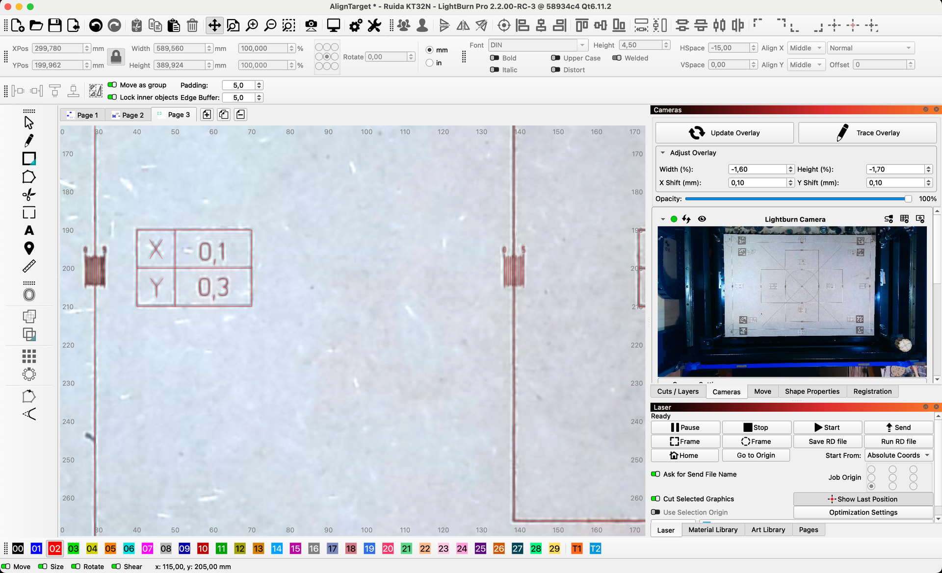

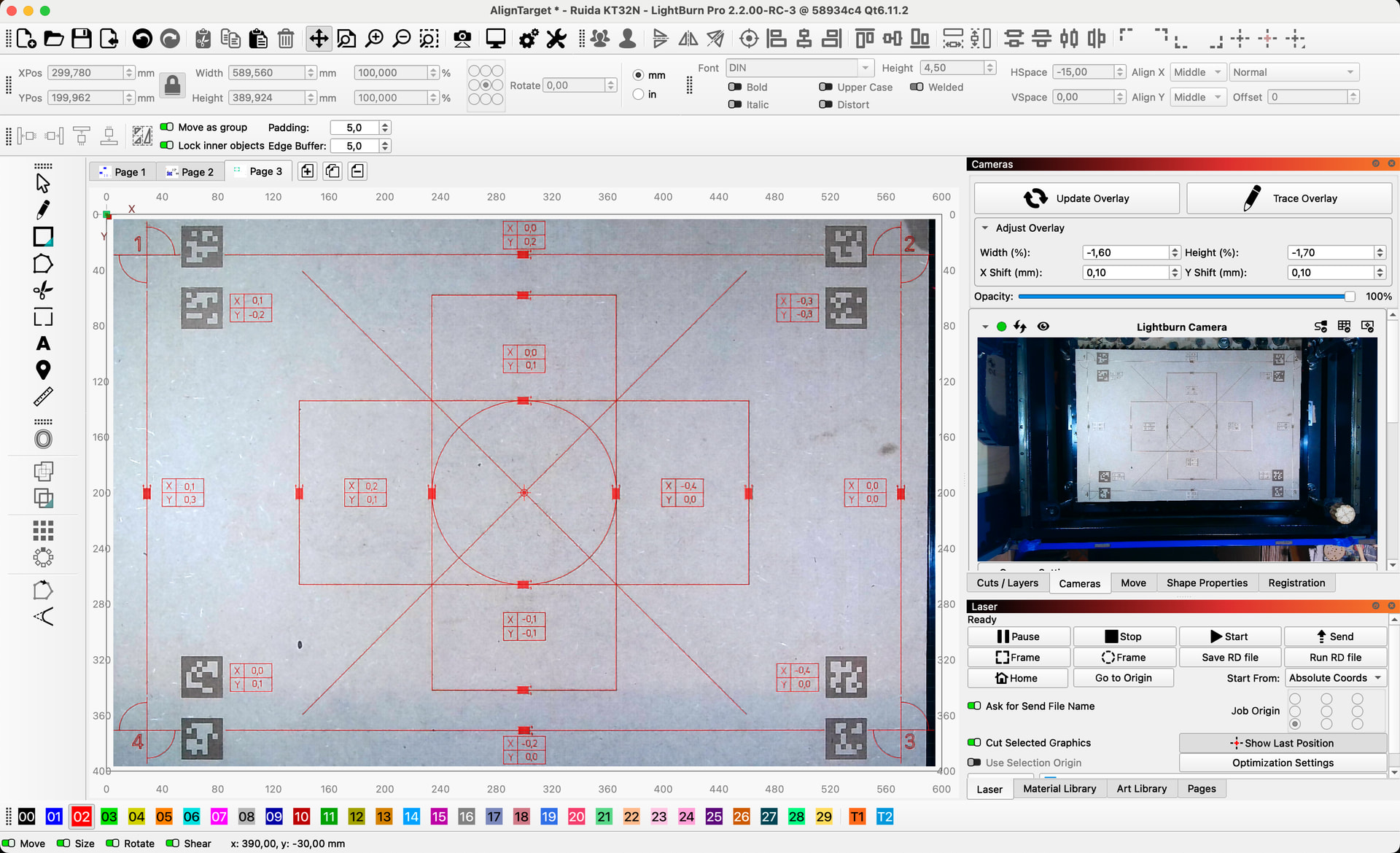

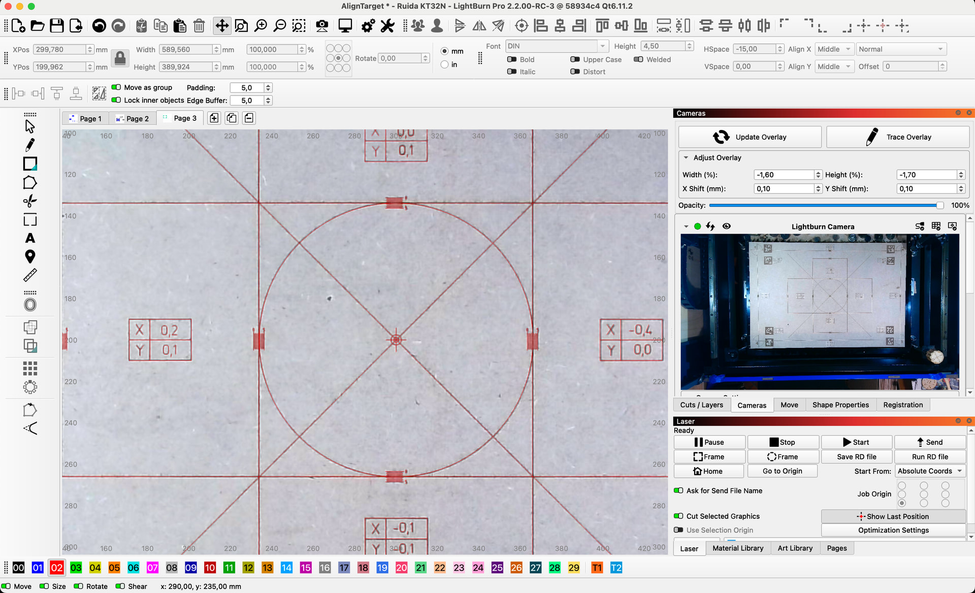

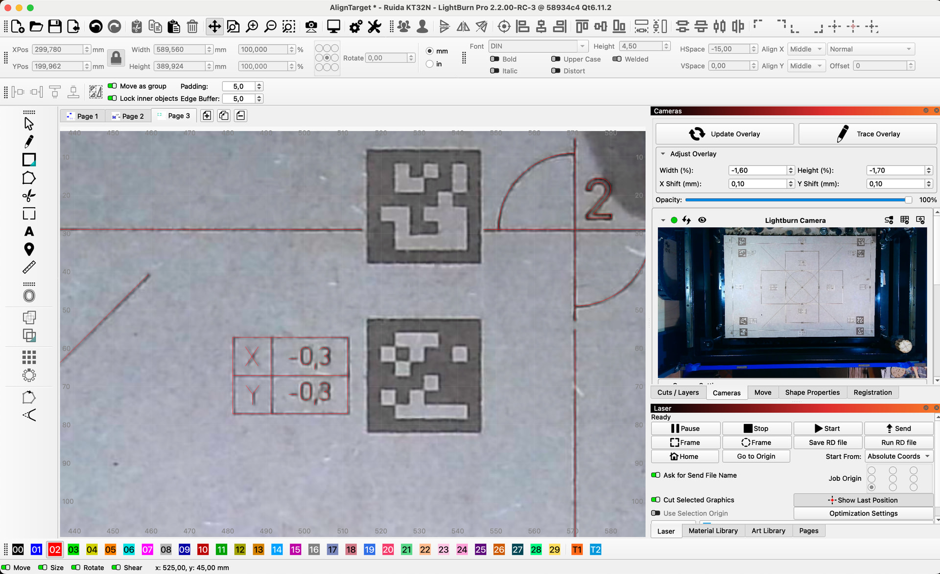

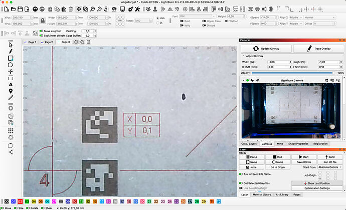

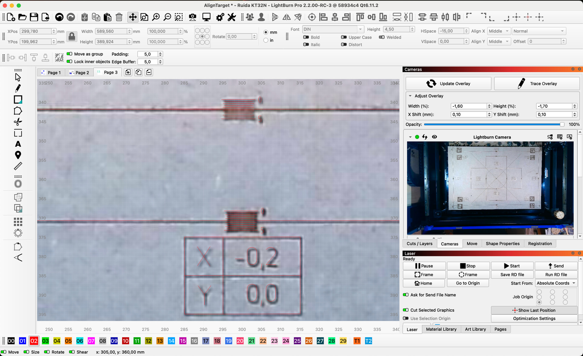

Here are the first attempts, which are better than anything I could achieve before.
I still have a little trouble placing the tags correctly now that they are made “by hand”. Hence the high % adjustment for length and width which I think comes from my “handheld” aspect ratio. (I should probably be able to handle that better with time)
The small boxes show the respective deviations in the area, I have used the average to have an overall adjustment. It will be more than fine for placing items over the entire work area for economical material use.
If/when it needs to be super accurate, I divide my work area into 4 to 6 segments and use the respective correction factor.
Guide lines of some kind, which should be engraved together with the alignment tags, make a big difference.
Now I have to find out how fine the repeat accuracy is, as I said, I use a fixed stop to “reuse” my alignment tags/templates.

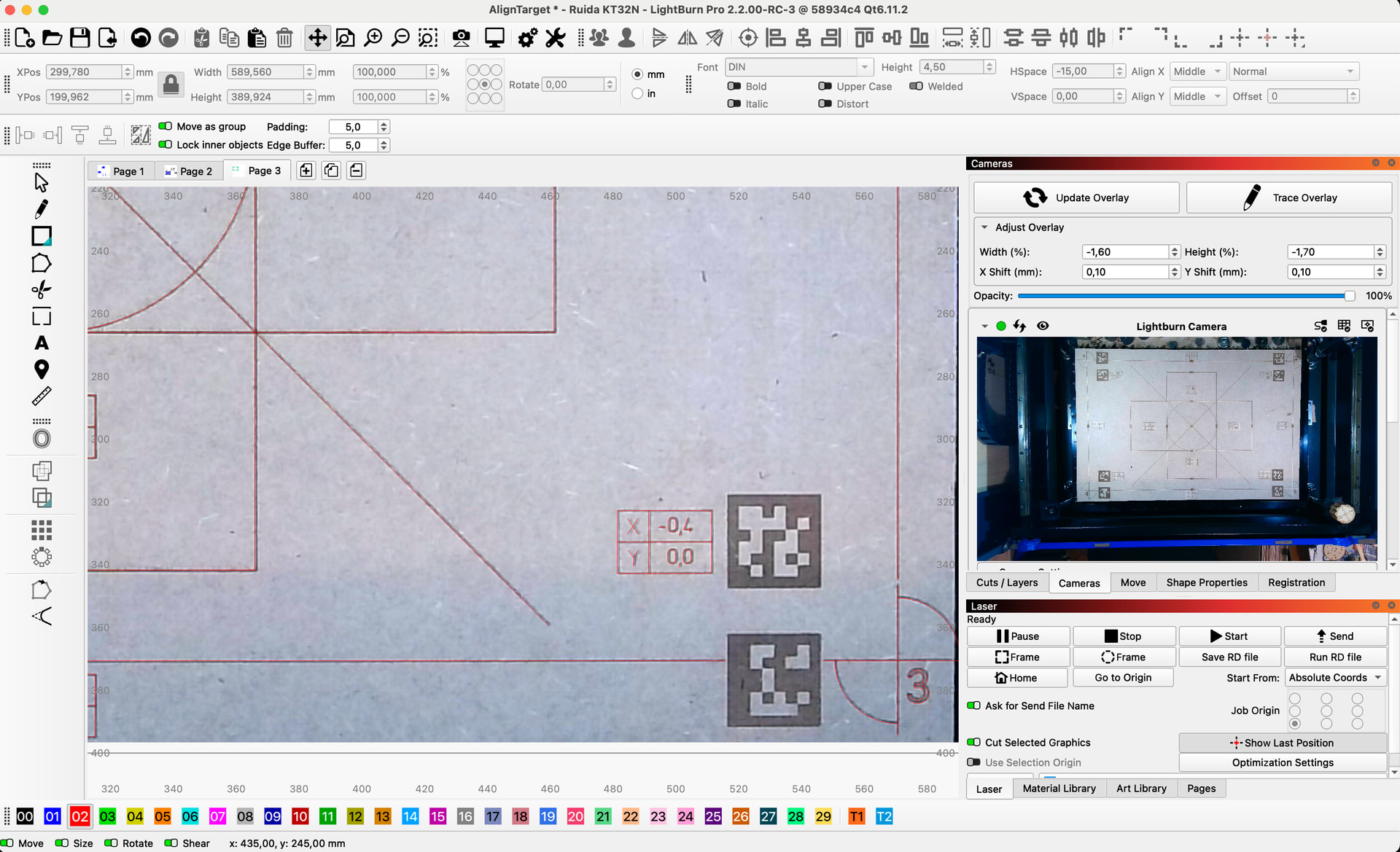

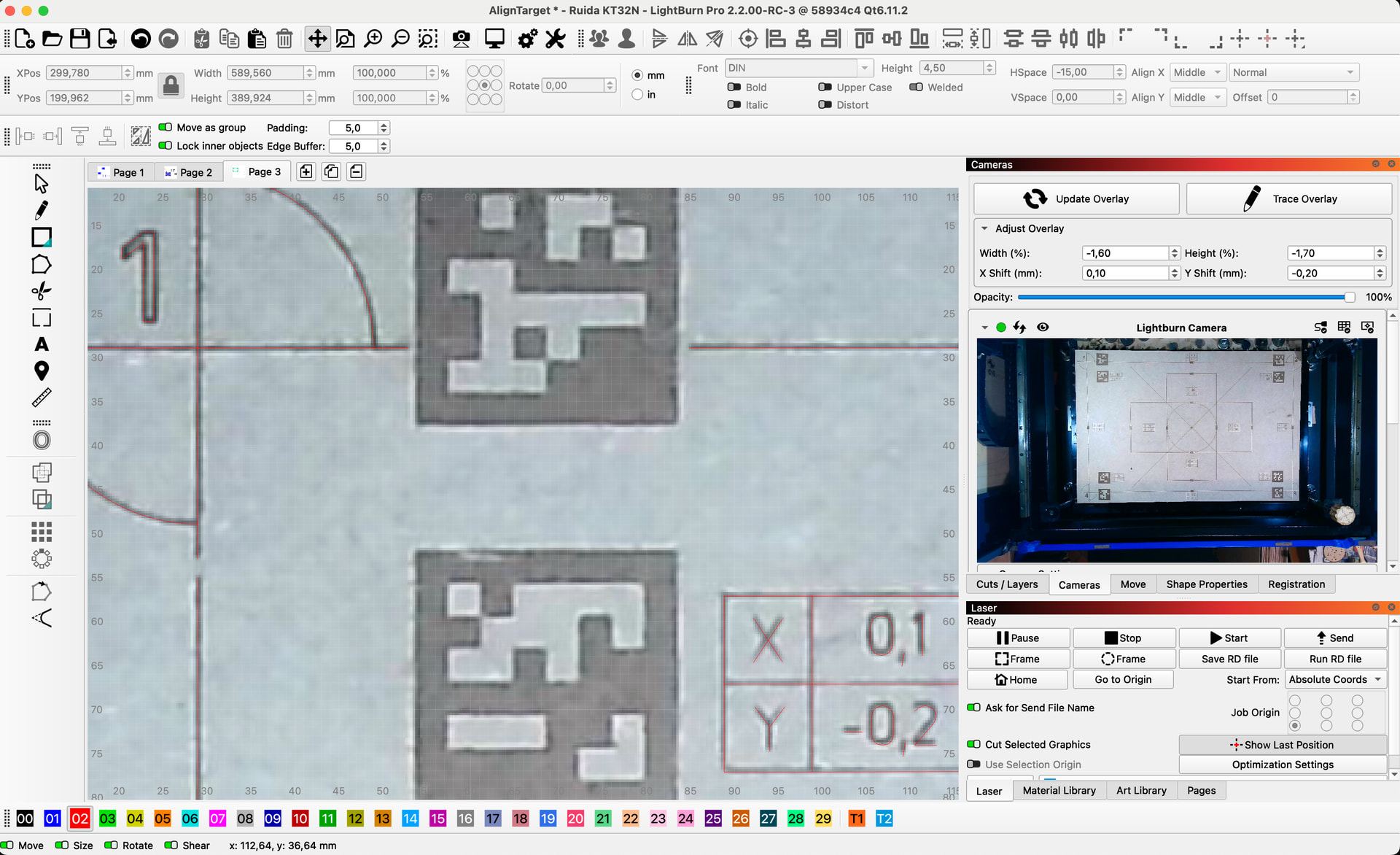

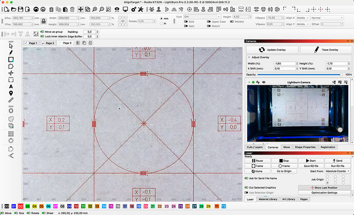

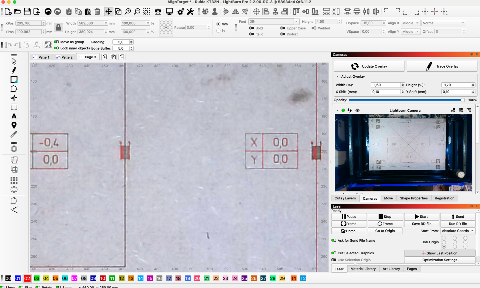

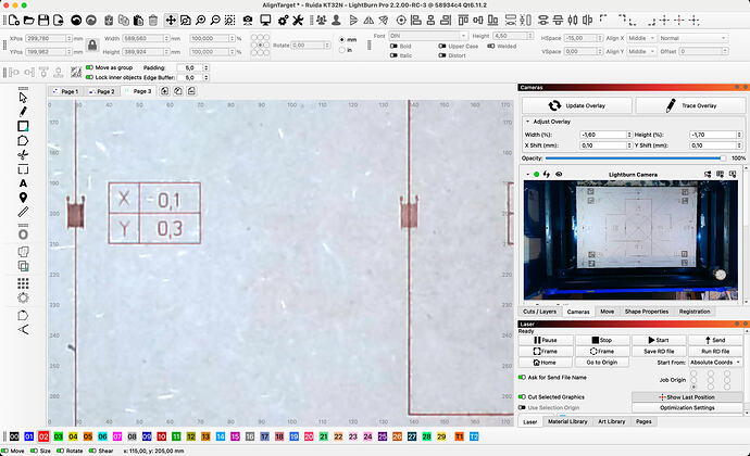

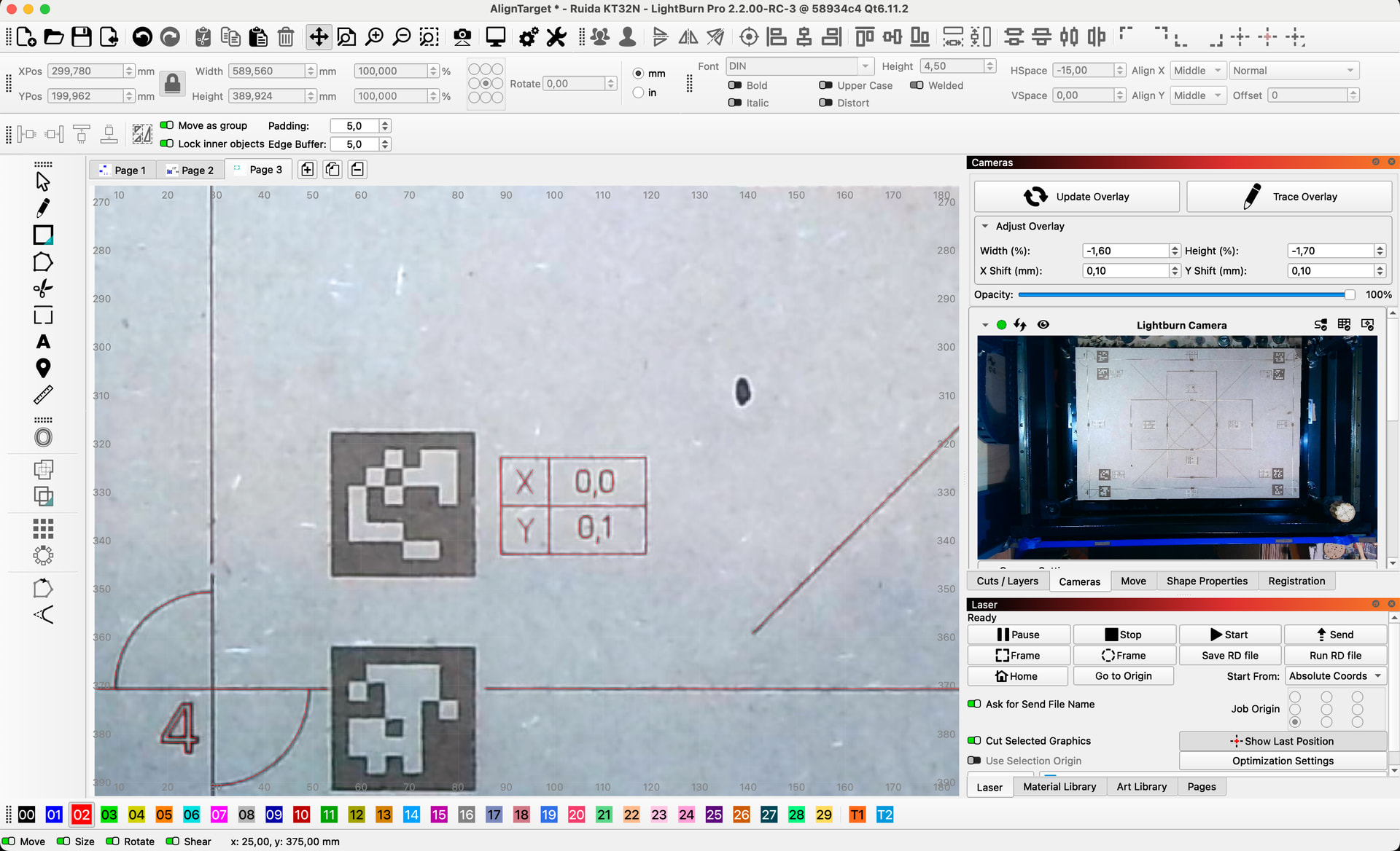

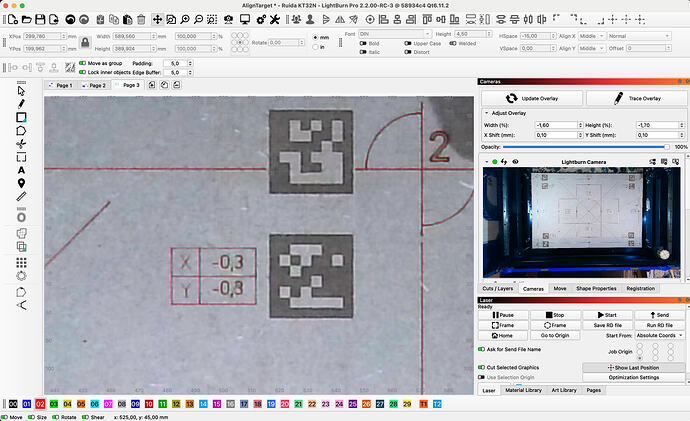

The images show the different areas with their deviation values - after “% deformation” has been compensated for, i.e. it is only a fine adjustment of the X/Y shift in mm.
Wow. I really like your alignment accuracy verification procedure. Really great to see how well it holds up over all the workspace regions. I have been thinking about measuring alignment accuracy in LB for a while already. Having a reliable metric for this would be super useful. Thanks for sharing!
I was a bit surprised myself. If we want high precision, lighting conditions and distance from machine bed to camera lens are very critical. I can reproduce double up errors in certain areas, i.e. 1mm focus change is equal to up to 2mm off target. Angle changes are even worse.
As long as you are aware of it, you can control it.
