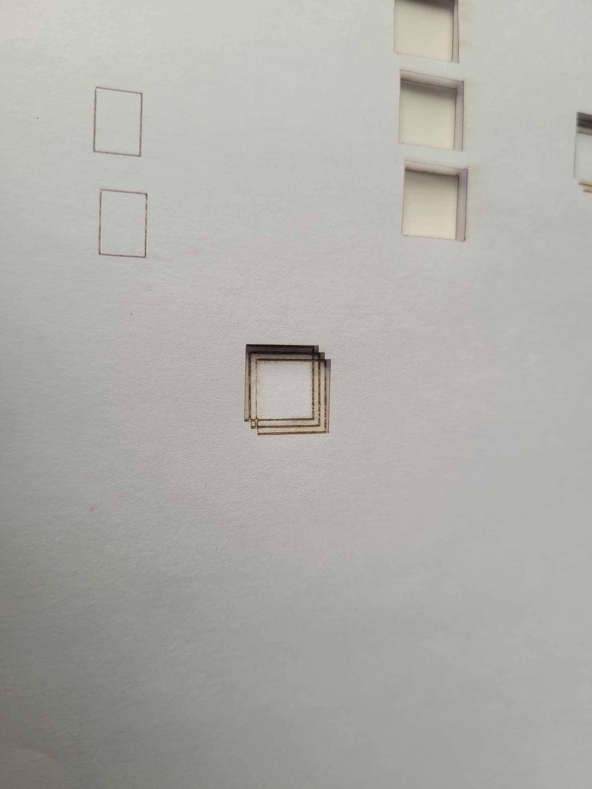

The generated G-Code seems to be wrong. It adds 1mm to all relative moves.
If have executed G10 L2 P1 X0 Y0
For instance:
I draw 3 10x10mm square positioned at Xpos=10.000 Ypos=10.000.
When I burn it, the all Sqares are correct BUT the second sqaure is shifted 1mm on both axis. The third Square is shifted 2mm on both axis.

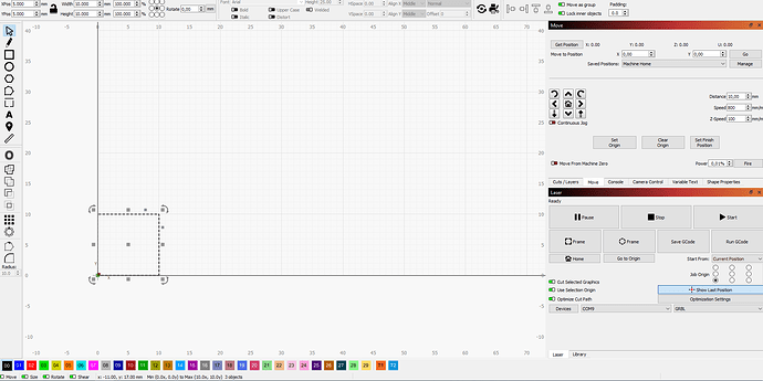

Can you take a full screenshot of LightBurn with the design loaded and Laser window showing please?
Note that i reuploaded the .txt file.
Here is the result: (image is rotated by 90° CW)
Is the gcode file created specifically with the .lbrn file that you’ve uploaded? I can’t duplicate your results.
Can you take a screenshot of Edit->Device Settings?
