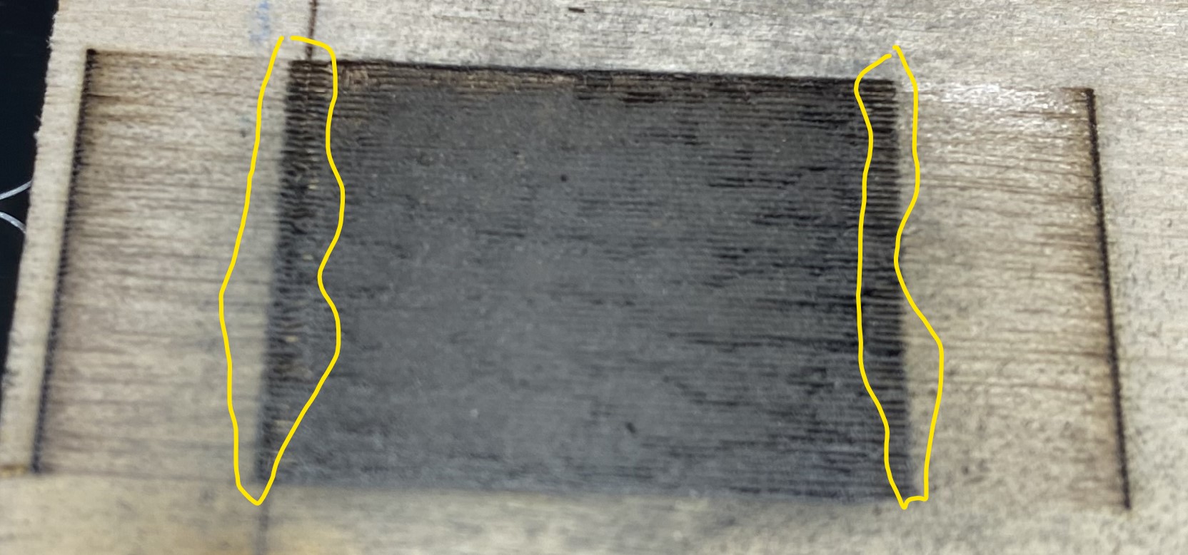

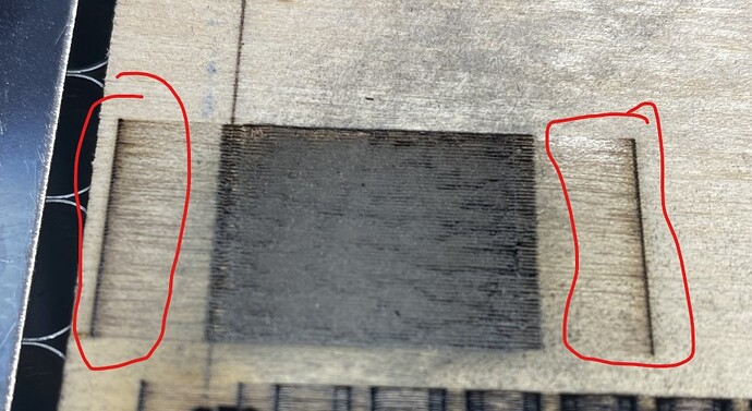

When engraving with “fill” and using over scanning I am getting these marks outside of my defined geometry.
What am I missing in my settings or Gcode. The laser power is reducing, but not turning off in the over scan part of the path.

Thanks for the reply. I have read through Marten’s post with your input a number of times before today. I have incorporated much of the input from that thread and still not quite getting the correct results. Laser cuts just fine, and engraves, but has what I would call witness lines at the over scan distance.

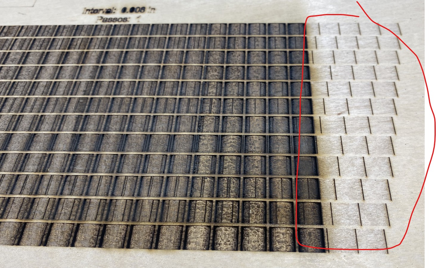

Maybe adjusting the Scanning offset or increasing DPI a little might help:
I have looked at the scanning offset adjustments, but I do not think this would be the cause for these “witness” marks. The laser is not shutting power off completely in the Overscan part of the move. You can see in the gcode that power is set to zero with the M10Q0 line and I have an M11 command after each cut move which should be turning off laser power too…correct?
I think this shows scanning offset adjustment is needed by a small amount.

Thanks two you both for the input. I turned off the over scanning and then it just burns deeper at the edges of the engrave because of the ramp down and up in speed.

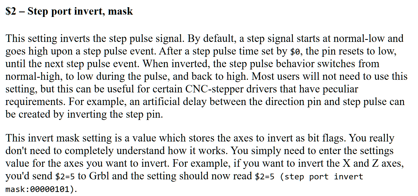

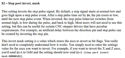

You can try a 90º Scan to confirm the same behavior in Y:
Then check if you have some option similar to GRBL $2.
https://github-wiki-see.page/m/gnea/grbl/wiki/Grbl-v1.1-Configuration
