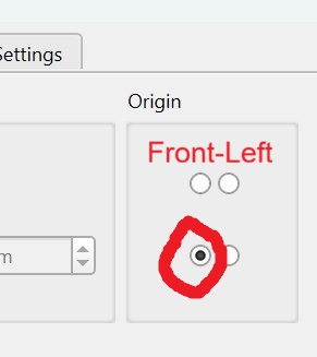

J ai une S30 pro
Qui peut m aider a calibrer lightburn en me donnant des etapes
Et si je lance la gravure ma tete laser bouge queques centimètres se bloque et elle fait du bruit comme si elle forcée merci
I have an S30 Pro. Can anyone help me calibrate Lightburn by giving me the steps? Also, when I start engraving, my laser head moves a few centimeters, then jams and makes a noise as if it’s straining. Thanks.
I have the S30 Pro. Your settings may have been changed. The machine is basically plug-and-play as delivered.
First, make sure you have the correct Home (Origin) position selected. Laser Tools, Device Settings window:
Let us know if that does not cure your problem. We may need to do more detailed settings checks.
