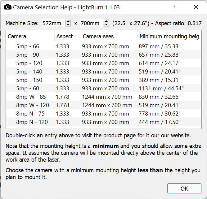

Have you gone through the tool available in Help->Camera Select Help?
It provides a good overview and a calculator to help determine the type of camera required.

I’ve run the helper with the dimensions you listed. See if this helps.
