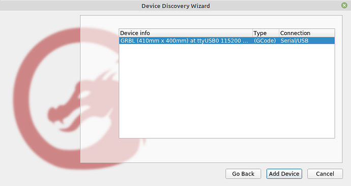

Lightburn can't connect to laser anymore
Disclaimer: Lightburn has worked on that machine without any issues for years.
I don’t know what changed that behaviour, but it’s completely odd.
As I said, the combo (Sculpfun S9 + Lightburn) has worked on the same machine (Linux Mint) without any problems from the beginning. It’s version 1.4 installed with the .run file, all permissions/group additions have been done.
It just can’t connect to the laser anymore.
Now the really weird part:
Since I thought about permission issues, I started LB with sudo through the terminal.
When I “Discover device”, it find’s ttyUSB0 and get’s the proper responses from it:
> Found port: PID 29987 VID 6790
> Manufacturer: "1a86"
> Product: "USB Serial" on "ttyUSB0"
> attempting connection... 115200, DTR setting: false
> Port open succeeded
> opener
> Grbl 1.1h ['$' for help]

It even shows me the configured device:
Once I’ve done this, Lightburn can’t connect to it anymore, always sends a G0 and doesn’t get any response:
When I run it without root permissions, the connection always fails…
Does anybody know, what the problem could be here?

@ednisley Thx a lot, those problems have all been cleared already.
I think the laser’s board has a problem. Maybe the firmware is corrupt or the board itself is broken.
I can connect to it with the screen command, ‘$’ and ‘$$’ commands work, but sometimes are really slow in answering.
When I send a ‘G0’ like Lightburn, it does not answer with ‘ok’ but with ‘Grbl 1.1h ($ for help)’
I’ll dig a bit deeper and if I find a solution I’ll post it here.
You can find the the firmware here: Firmware Update & Settings - Diode Laser Wiki Try to flash it again and check if that helps.
Thank you - that’s the firmware that’s already on the board. Maybe I’ll try another flash, but I suppose, it’s a hardware problem.

Ok, now everything works again.
What did I do:
  1. Moved the .config/LightBurn directory to LightBurn.bak - not the desired outcome
  2. Reinstalled 1.4 by running the install .run-file - didn’t solve anything
  3. Flashed the firmware available from Sculpfun - not it works again.
    (Of course I did all the device permission checks about 20 times, no changes)
Strange, but it looks like the firmware of the laser has been corrupted anyhow and maybe my first flash attempt didn’t work.
