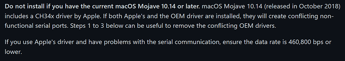

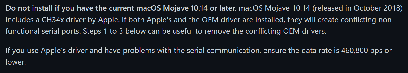

Misken wrote: “On the GitHub page of the second driver, there is a note that on newer macOS versions, you should not install any driver because it conflicts with one that is provided by the OS already.” I’m not sure what is meant by “of the second driver”. I can’t find the description referred to by Misken. Not sure what to do.
I assume this is what’s being referred to:

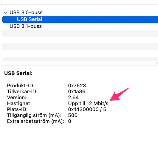

Ah, thank you! And how do I check “data rate”?
Is this the speed? If I check the USB speed (when connected to the laser) and it says “Up to 12 Mbit/s”.
I believe this is referring to the speed that the application is configured to set the serial connection. It’s not something you need to set at the driver level.

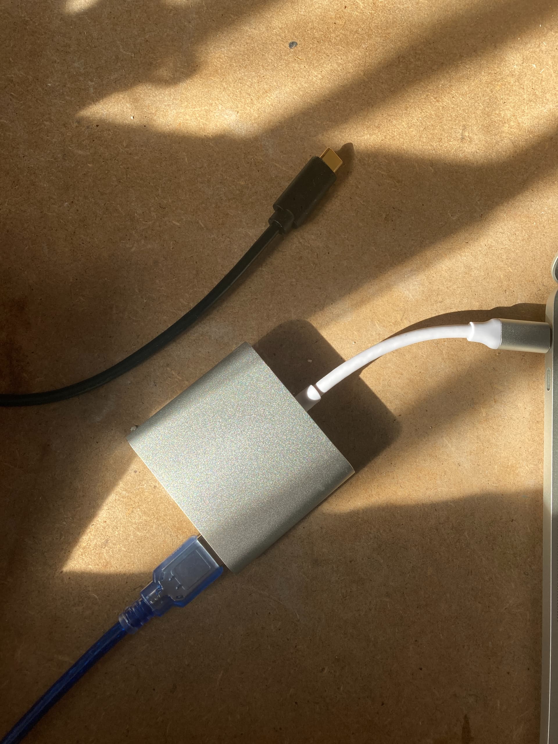

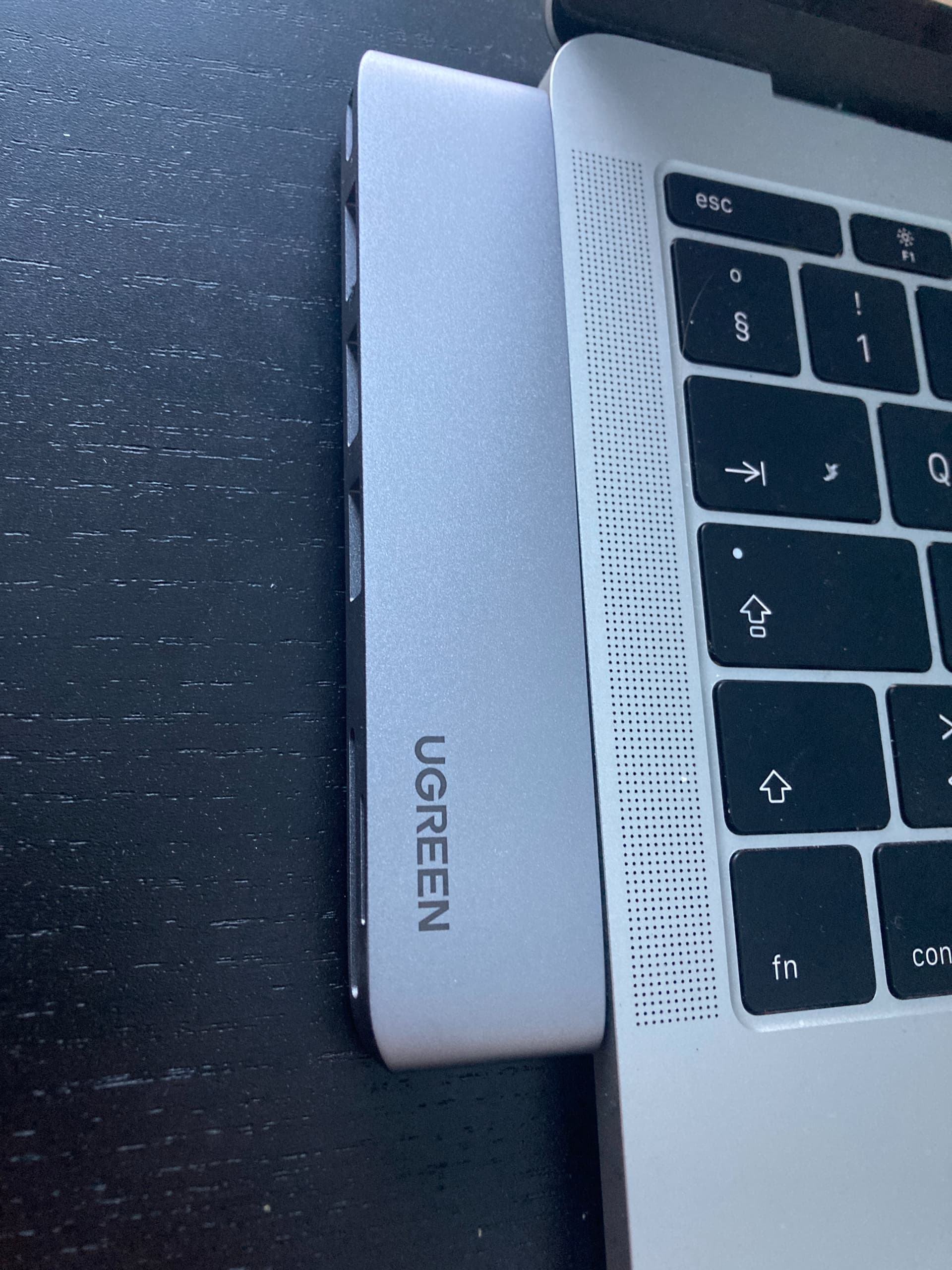

Also, can you confirm how you’re connected to the machine? Is it through a hub? If so, can you try eliminating the hub? If you have multiple USB ports, try different ports. If you have other high quality cables, try those other cables.
First: I’m trying two different cables
  • one that I’ve used before with a hub. Have tried it on my two USB ports (and with two similar hubs).
  • I’ve also bought a new cable that can be connected directly to the computer. That didn’t help.
    I’ve now bought a different kind of hub to see if that makes any difference. It should arrive today.

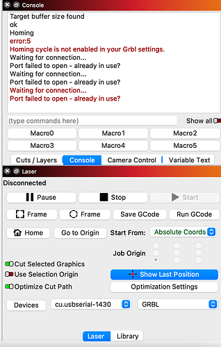

Update: Just got a new hub.

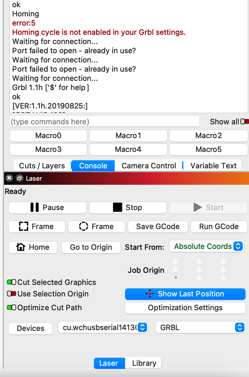

Tried it with both cables. This time I get a reaction in LIghtburn - two new ports and a new message:
Any idea what might be causing this?
