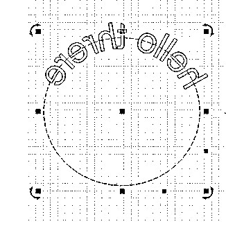

It’s not Possible in 1.4.0 to Mirror a Text on a Path correctly.
It will Mirror on the opposide of the path, but not that way that you can laser a mirror from the back

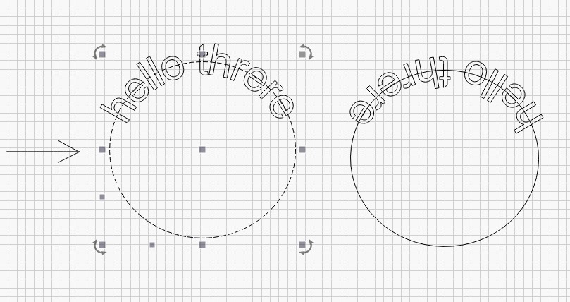

Hi all you have to do is drag from left to right or right to left
you perfectly shown how it looks the wrong way.
to stay with your example it should look like that
bsp

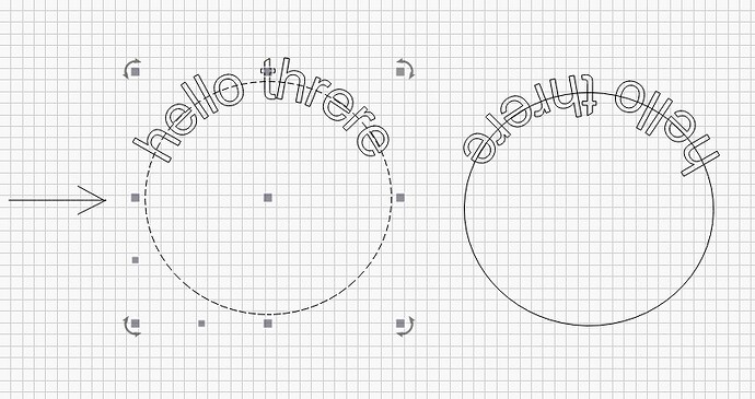

Here is a workaround.
yes that seems to work fine
