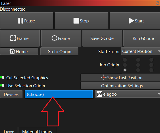

Did you check that selected the correct COM port in the pull down menu in the Laser Window?

Can you show me where the drop down window for the COM is located? Thx
I at least got the camera to work. Ive got art on the page. I press start for the laser and I get a dialog box that says cant communicate with the laser, it might be busy.
Lower left in the Laser window.
This might be solved when you select the correct COM port.
These are my choices

try - cu.usbserial-141420
