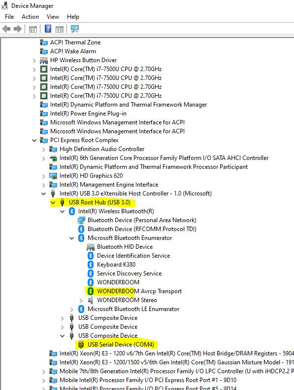

It’s feasible that LightBurn generated traffic to your S9 could affect any other device connected to the same USB Root “highway”, and vice versa, for example you can see here how this Wonderboom shares the same connection resource:
Do you have any other USB devices also plugged in, like a webcam? external hard drive…gaming mouse..?

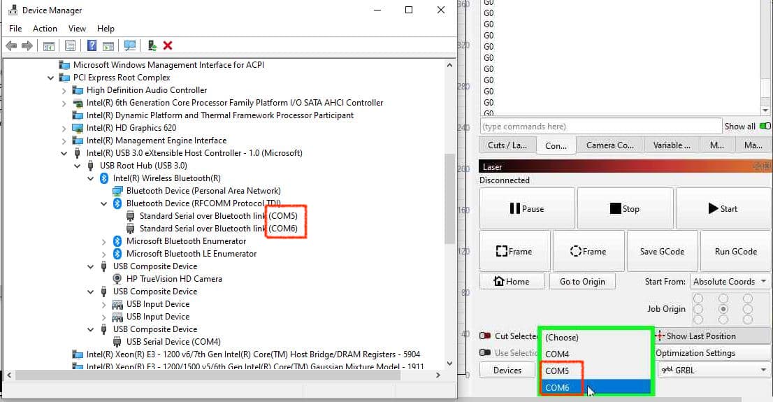

My suspicion is that if your machine is off and LightBurn starts up it may try to autodetect/grab a com port used by bluetooth, since some bluetooth devices use virtual com ports , I’m guessing just for sending simple track and volume commands:
To prevent LightBurn from trying to strike up a conversation with one of these ports, right-click on each of them in the port list and “Exclude” (see docs):

When Lightburn starts it start with Com3.
The music is also skipping.
When I changed it to com 4 the music was playing without skipping.
It also worked when I selected Com 7 - The S9 uses this com.
So thx allot for you support I can finnaly listen to my music when using my S9. :slight_smile:
