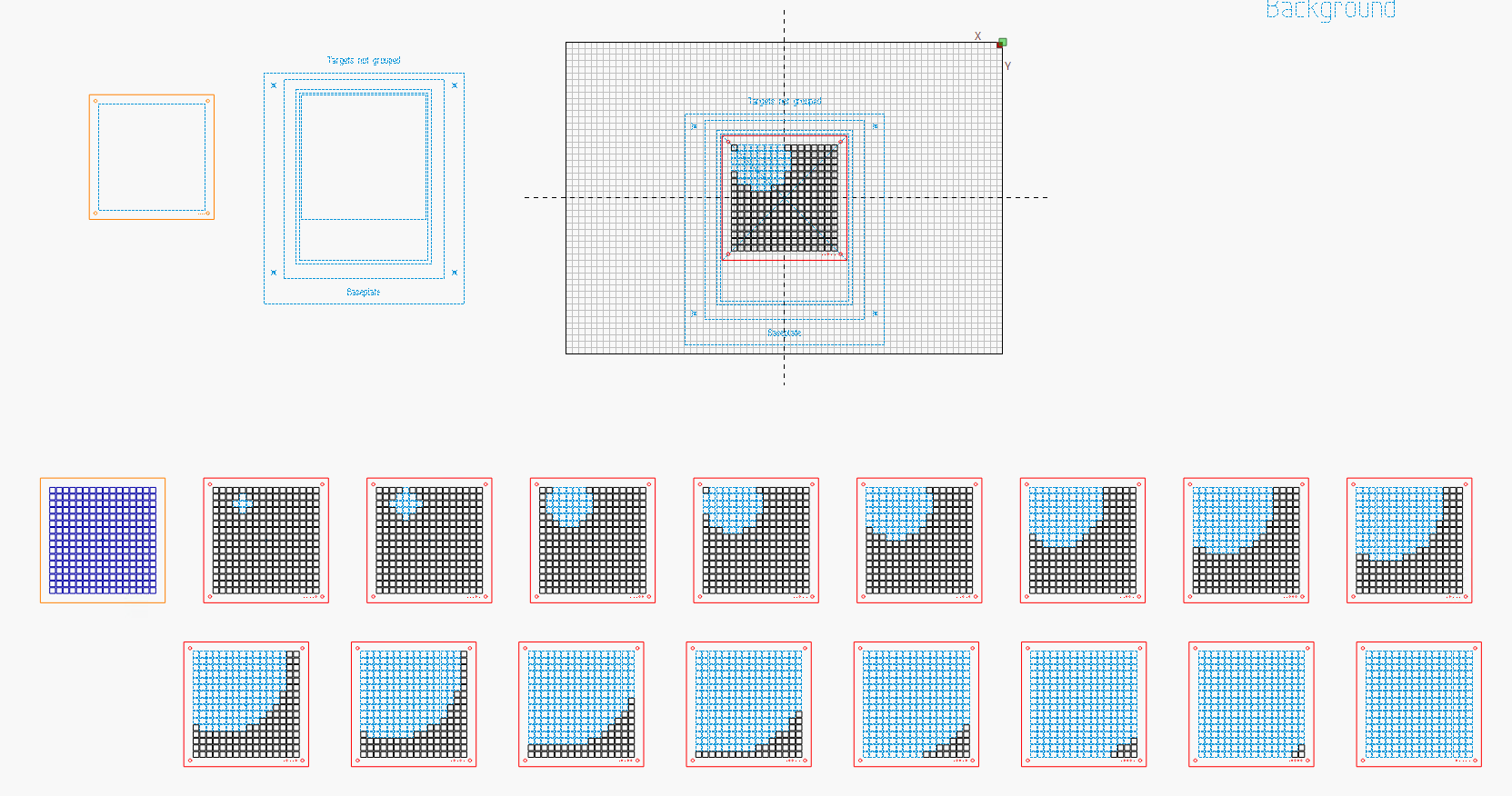

If the SVG colors exactly match the LightBurn palette colors:
CellCut = "black"               # C00 Black
SheetCut = "red"                # C02 Red
HeavyCut = "rgb(255,128,0)"     # C05 Orange        black mask paper is harder
HeavyCellCut = "rgb(0,0,160)"   # C09 Dark Blue     ditto
Tooling = "rgb(12,150,217)"     # T2  Tool
Then the magic happens:
All the colors in each SVG file were automagically assigned to the corresponding LightBurn layers during import and the LightBurn layouts were ready to cut:

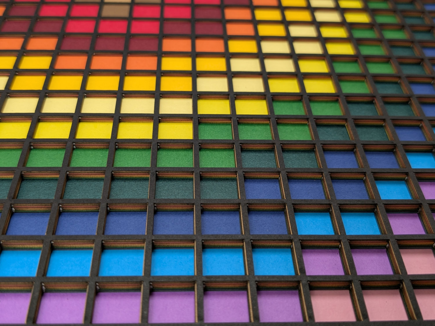

Alas, those cheerful colors come from the cut paper, not the LightBurn layers. :grin:
