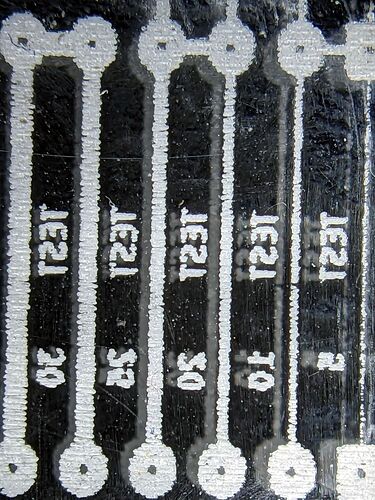

Ok I think we got there ! and a big thanks to everyone that made time to assist me with great helpful comments. I think maybe John got there first with the scanning offset being the main issue. I watched the Lightburn tutorial on Youtube and followed the offset tuning method which I have done from 500 - 10,000mm in 500mm steps.
The image below shows tracks of various thickness lines from 0.12mm to thickest at the top of 0.76mm. This was done at 6800mm and 30% Power. I didnt find any improvement using pass through mode. I think I would be happy with tracks above 0.5mm as being safely engraved. Do you think there is room for improvement I think I am at the process limit for my equipment?

What do they look like after you etch off the unwanted copper… Probably the best test.
I’m going to etch my target board tomorrow which is nothing special. But I will take some pictures. I have adjusted my design so all track are above 1mm and increase clearance around the ground plane. I am confident this will work as nothing notable about the mask or etching process

I think engraving from the PNG image is costing resolution, but it’s hard to tell.

The line interval could be a bit smaller, but IMO tracing the PNG to vectors and engraving at (almost) the machine’s ideal line interval produces better results than attempting to force-feed pixels from the PNG image directly to the laser.
The 5 mil = 0.13 mm line isn’t very good, because the laser bandwidth isn’t high enough to allow such fine detail. At 400 mm/s, that trace is only 300 µs wide but the power supply has a 1 ms response time: the tube can’t get up to full power before the pulse is over.

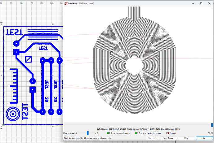

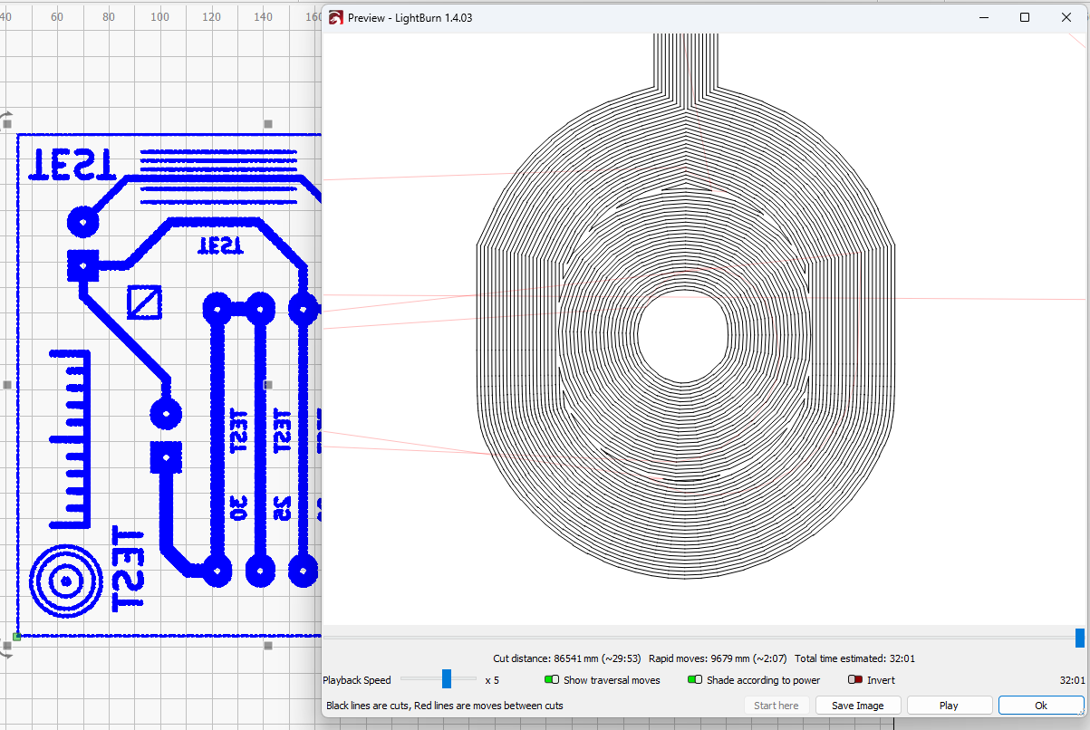

Another idea: you can also try to change the fill mode from linear fill to flood fill or offset fill, which might get rid of the pattern from many very short lines. But this depends on the spot and object width, whether it works well or not. So might not work for every trace on the board. And you need a vector graphic before, I don’t think this works with images.
Normal fill
Offset fill
As you can see here, there might be some problems of empty spots when line width and object width don’t fit perfectly…

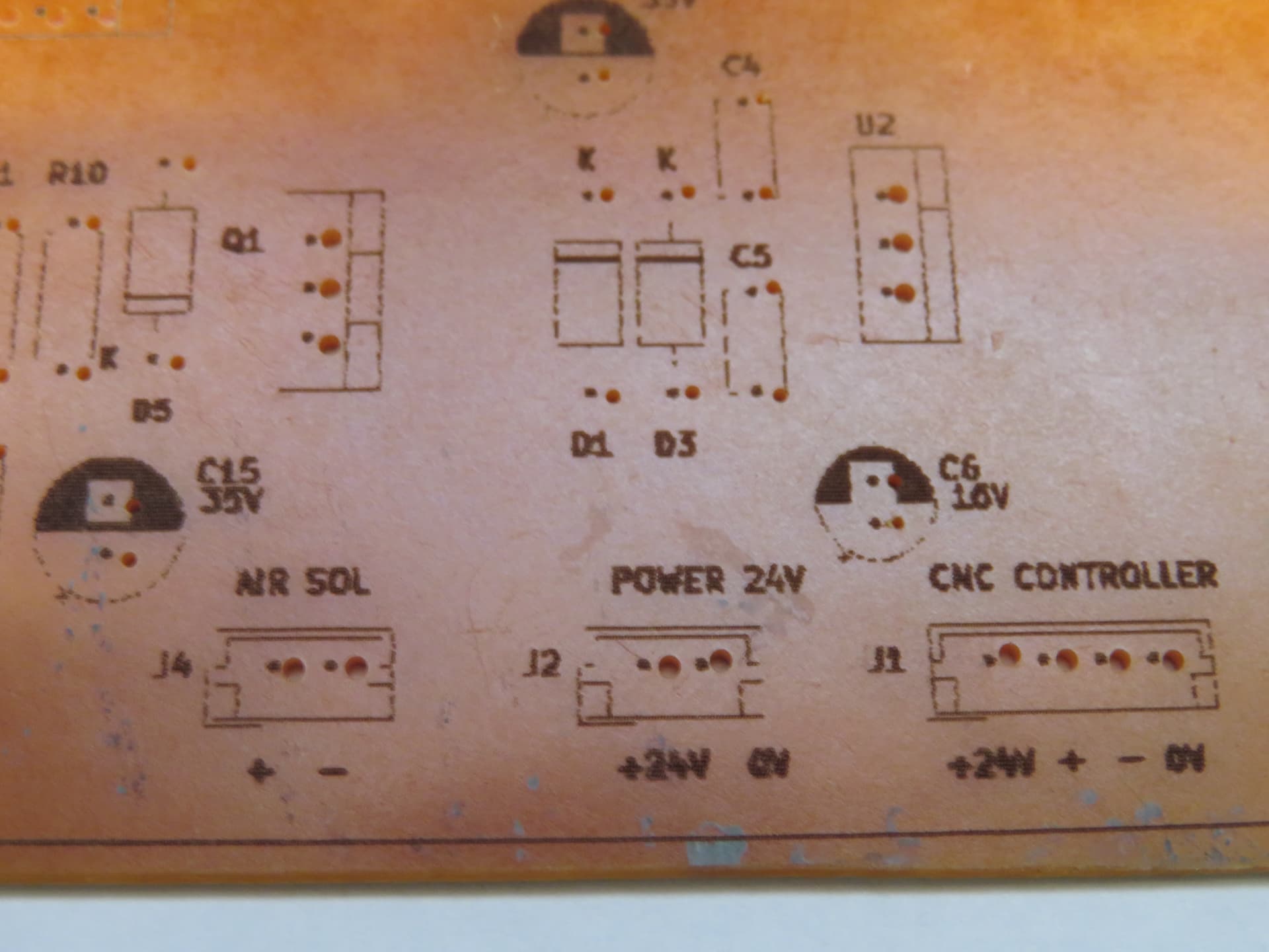

I also laser engraved the silk screen layer on the PCB top side and I think this worked out quite well for a prototype. I hadn’t planned to engrave the ident layer, so I had not considered alignment of the board when flipping it over. I did this by eye and was within about 1 mm but this could be improved with some type of fixture plate.
Next time I would increase both the text size and body to a bolder font in the future. I do wonder if there are any styles of font that would work better than others? I used phenolic material boards as I think this is a safer option and does take a mark well unlike fibre glass.

Sanserif = Ariel
Serif = Georgia
