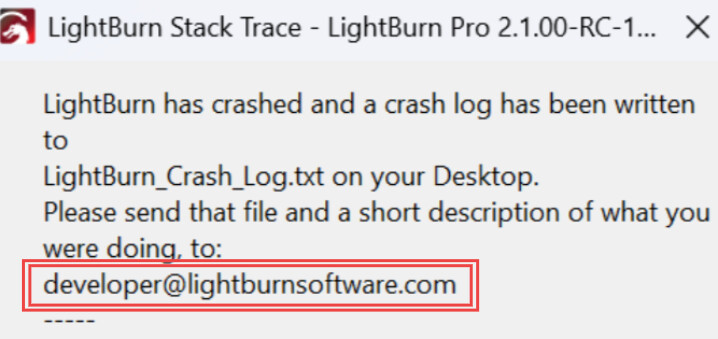

I’m using the original licensed EZCad3 with the authorization key inserted into the USB port. I’ve installed the latest version of LightBurn Pro 2.1.00-RC-11 with support for EZCad3 drivers. When I try to search for the correct driver, LB crashes. After manually installing it, LB crashes when I start it. If I turn off the EZCad3 machine, LB starts successfully, but if I turn on the EZCad3 machine, it crashes immediately. It’s a pity, as I really want to switch to LB.

You have to send the Lightburn_Crash_Log.txt file with a brief description of your system and what you were doing.
Unfortunately, I couldn’t find this file on my computer. I suspect that the problem lies in the driver rather than the LB itself. I’ve checked both computers.
Then you can enable Debug Log, do your things to get to crash and send the Debug Log
Great! It worked out.
