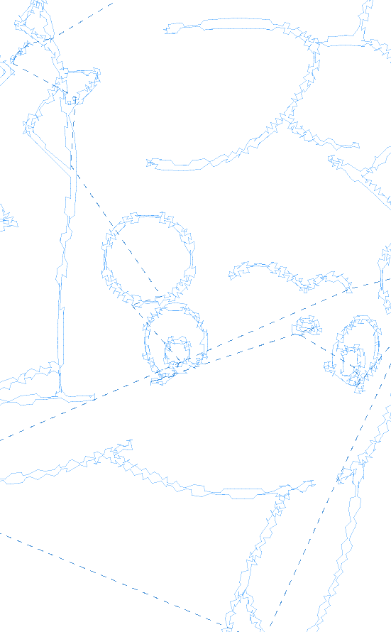

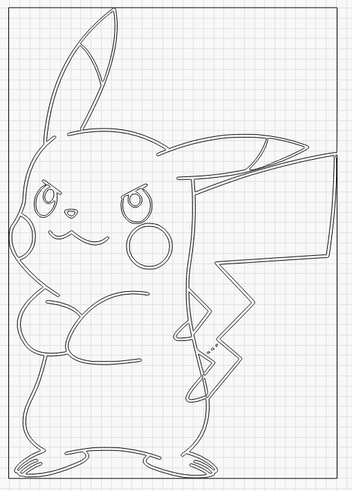

When saving to gcode, the image is distorted.
This is what it should look like,
This is what the gcode looks like:
Please assist?
Please assist?

That sort of problem generally happens when using a version of LightBurn downloaded from somewhere other than the Official Site:
Export a config bundle from the existing version, download & install the most recent version covered by your license key, import the config bundle, and see if the situation improves.
The fact that the G-Code appears rotated by 180° may be covered by this Troubleshooting tip:
