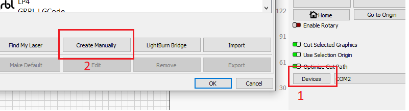

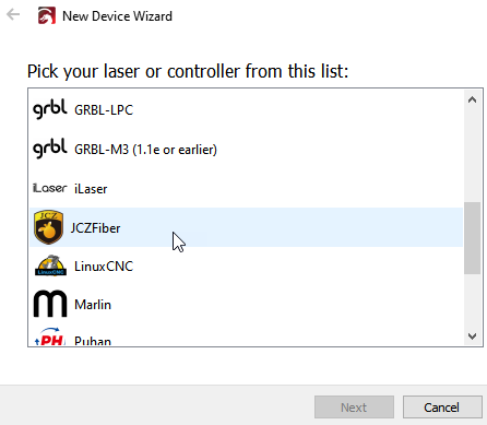

Try adding the laser manually.
Click “devices” then “create manually” , Select JCZ from the list of controller types.

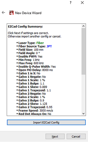

Then import the markcfg file from the USB that came with the machine.
“import EZCad config” browse to the USB, you should see a list of parameters one you select the correct file… next next. let us know if that works.
