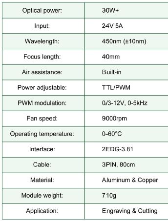

I use the K30 Laser from Laser Tree.
K30 Laser Tree parameters
I use a oscilliscope to be sure that I have the correct PWM pin. With ESTLCAM I have a PWM signal with ca. 1KHz and it works fine.
