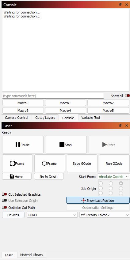

If it happens again, make notes of any error or alarm messages in the Console Window - more info here:
Laser Is Connected, But Not Responding?

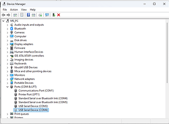

Hey, I checked back with laser today but I still got the same result but now the 4th com port says laser is ready, will this screenshot help?
Is COM3 the only option?

Right-click the ‘Devices’ button to have LightBurn rescan the devices/serial ports, and at this point should reconnect and become ‘Ready’ again. As the connection is made, you should see a flurry of activity in the Console Window, if you do not - try selecting a different COM port, if still nothing try a different USB port… and then try a different USB cable.

I tried all of your techniques, they didn’t work. Also you can find that there are multiple com ports. Idk what to do now. I also checked all the com ports then switched the cable to the other and tried again. The flurry of console activity you mentioned isn’t happening. Any ideas?

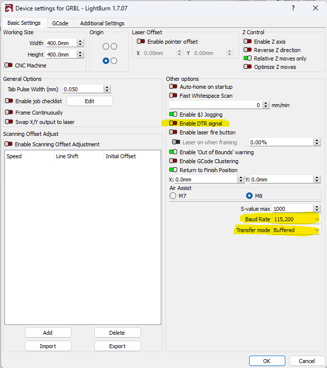

Check if these device settings I’ve highlighted are the same at the new computer as they are on the old computer that is working:
It is unusual that you have so many COM ports showing.

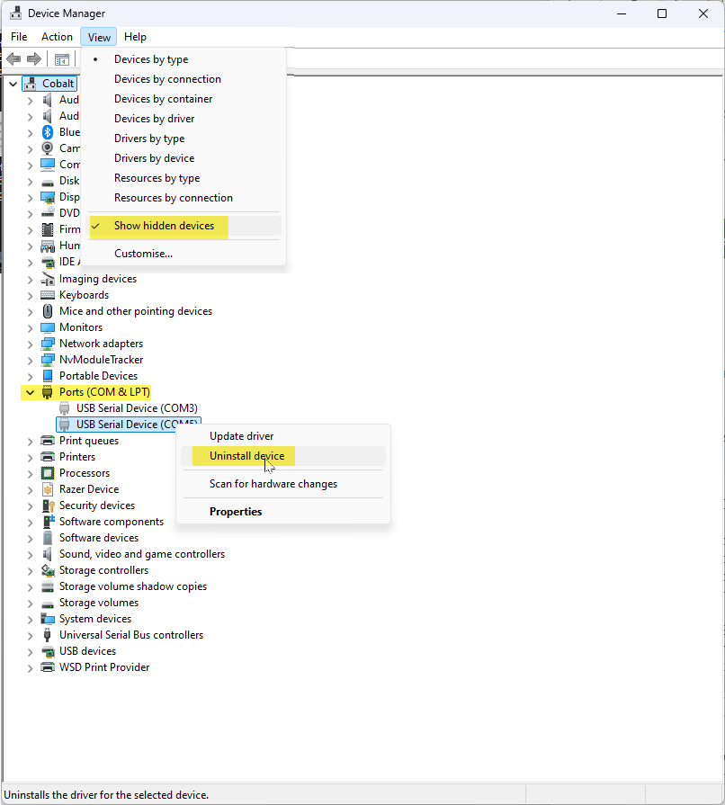

It might help to clean out some of the Windows assigned COM ports for devices that are no longer present. If you configure the Device Manager to show hidden devices and then expand ‘Ports’ what do you see?
Unplug the USB cable to the laser, then right-click and uninstall all the greyed out (not present) COM ports devices using device manager, now when you plug the laser back in Windows should see it as a brand new device and automatically setup a driver for it and assign it an available COM port.

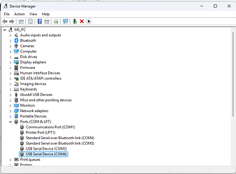

Here are some screenshots of what happened:
Before
After

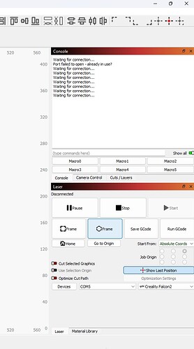

And here is the console in lightburn:
does this help?
Interesting, which port will disappear if you unplug the usb cable to the laser?.. COM4?
I’m not sure why you are seeing the ‘serial over bluetooth’ does the Falcon2 also have a bluetooth connection option? having that also on COM4 also is possibly causing problems but hopefully somebody else here with a similar machine will know more about this?
What bluetooth devices are you currently using? (search in Windows for ‘Bluetooth and the devices settings’), if nothing? try turning your bluetooth off for a while.
Please also answer the other question I posted earlier asking you to compare the highlighted settings at the new computer vs the older working one.
