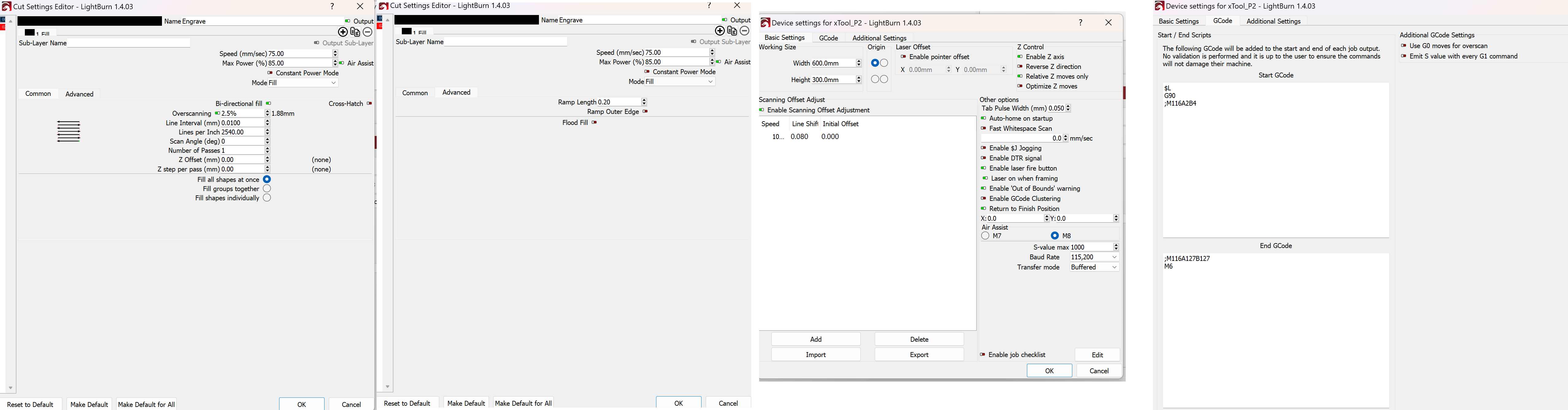

I am currently trying to use LightBurn for engraving rubber stamps and have encountered a significant challenge. When the laser encounters fine details, it slows down considerably, leading to the destruction of letters in the process. My goal is to maintain a constant engraving speed throughout the entire graphic
I’ve reviewed the settings in LightBurn but haven’t found a solution to this issue. Any guidance or assistance you could provide would be greatly appreciated.
I have an xTool P2 laser using GRBL controller.

This is probably due to a combination of acceleration and speed settings, where the acceleration is too low to achieve the desired speed in the available distance. As a rule of thumb, laser heads cannot achieve high speeds over short distances, because the motors cannot produce enough torque to move the mass.
If the short-distance speeds are too low, then the motors must use more acceleration to reach higher speeds, but configuring higher acceleration than the motors can produce will lead to their stalling on longer vectors.
Feeding the acceleration setting and the length of the finest detail into the RepRap calculator will give you an idea of the maximum achievable speed over that distance, which is generally a small fraction of the speed achievable over longer distances.

That’s almost certainly true, but keep in mind that the GRBL controller only knows about the axis settings for maximum speed & acceleration.
If you can match the XCS settings, then the machine should produce equivalent results, but you must match all the settings before reaching that goal.
Hello ednisley,
Thank you for your message. While the details will become clearer with the video, I’d like to mention that the speed and power settings are consistent between xTool Creative Space and LightBurn. However, LightBurn offers additional refined settings, such as ramp options for rubber stamps, and it supports higher line intervals. I attached screenshots of all my settings for your reference.

do $$ in console and also post those. They are the important bits too
