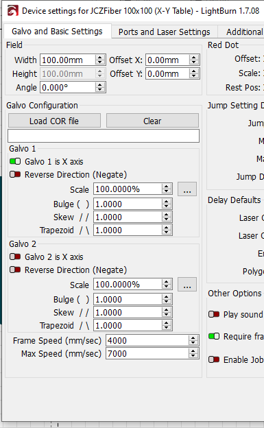

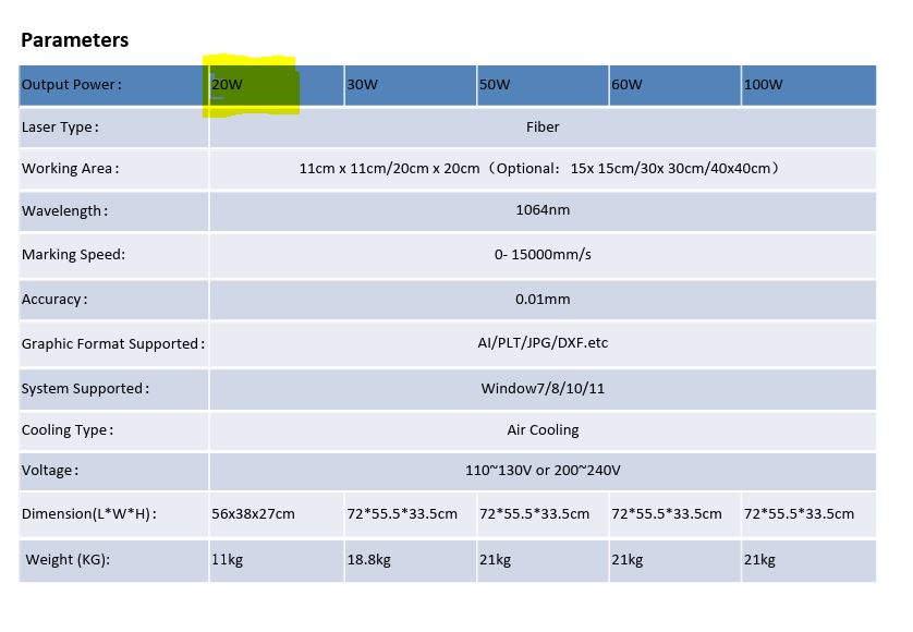

Hi I’m using the Commarker B4 20W and used to be able to set my speed to 15000mm/sec now it will only set to 7000mm/sec max
Does any one know how to fix the problem?
It’s at the bottom of the device settings window.

I engrave pilot device labels 48mm X 44mm black covered aluminium with power setting to 20% and speed set to 15000mm/s, the labels does not need high power and mark very good.
That been said I find that 7000mm/s with a setting of 1% power works best and only takes 25 seconds to mark
