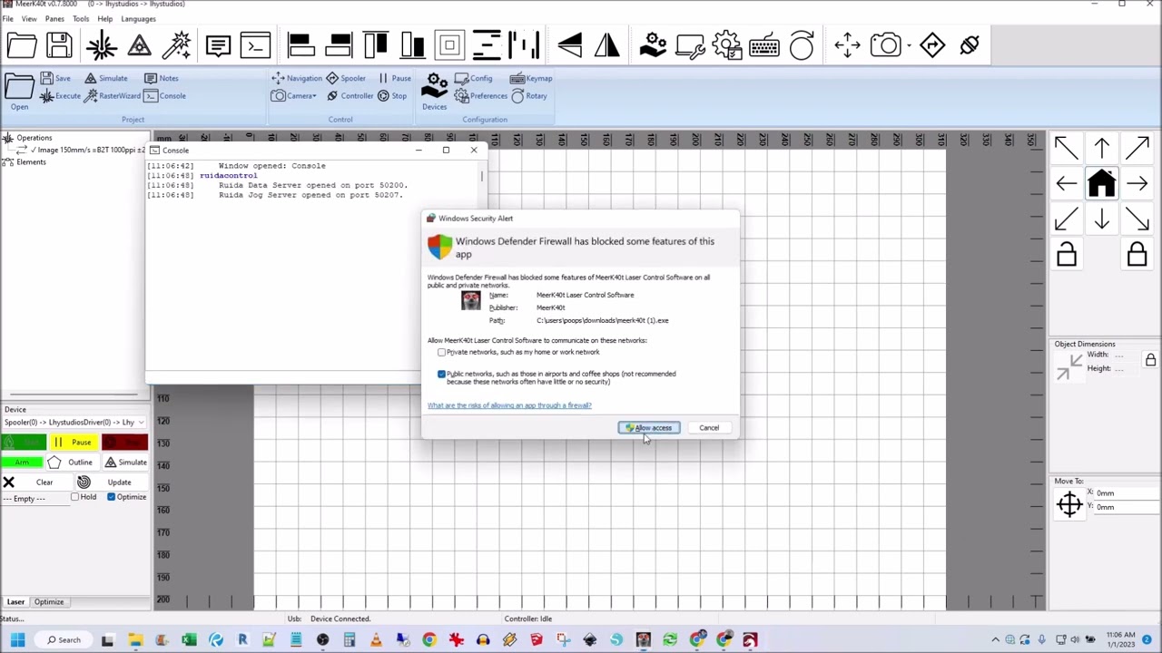

You could also run meerk40t as basically a translator between Lightburn and the K40 like I did on my first Co2 (K40) while waiting for the Monport controller to arrive.
How does that work?
