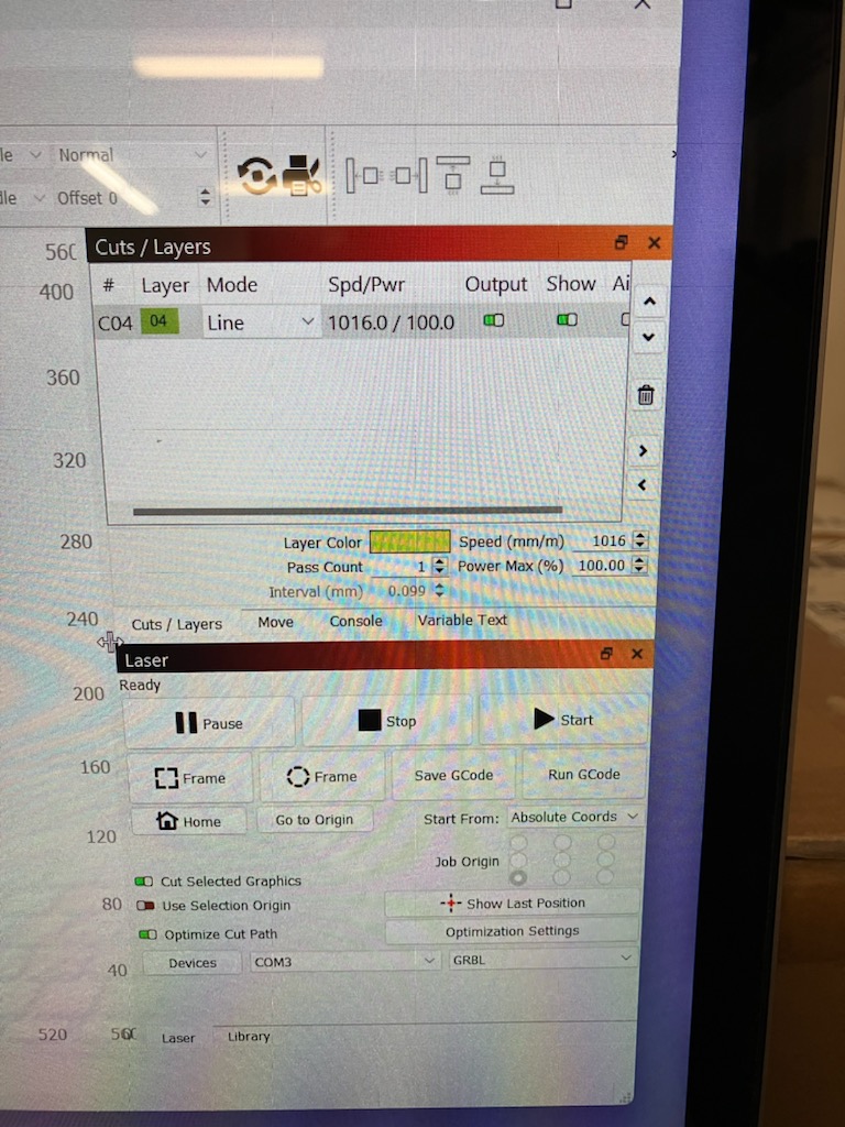

Can you post your cut/layer window for this cut?
Would this be what your referring too?
We are hoping to use this laser to make a plaque or keychain with the the dog they adopt or donate for care too. So scanning in a picture will be the next hurdle once we can engrave something.
Assuming a 10w output laser? What is material and thickness. That feed and speed should leave a mark, but it won’t cut at that speed.

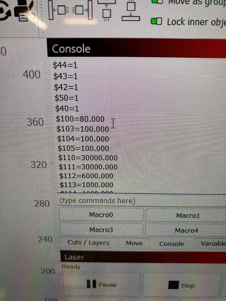

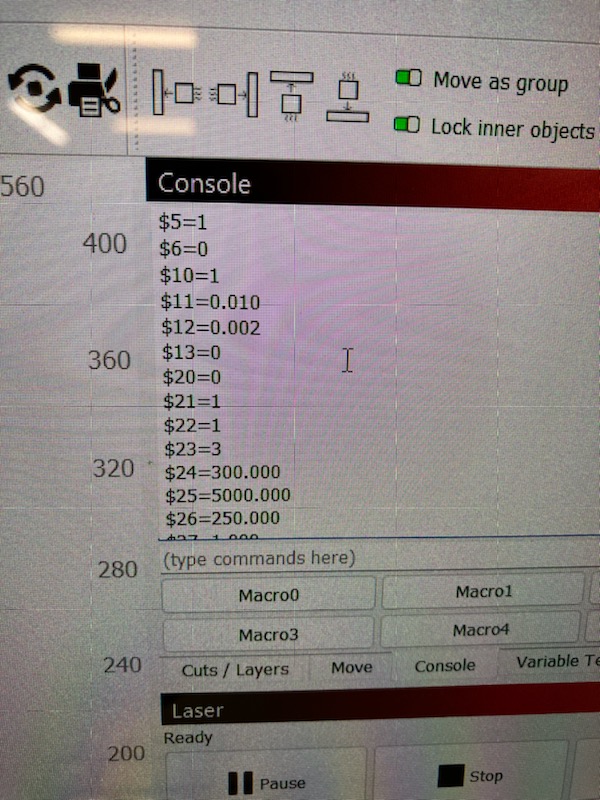

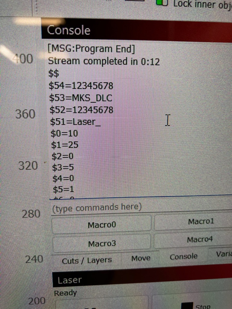

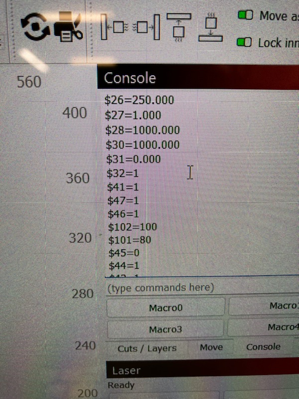

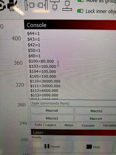

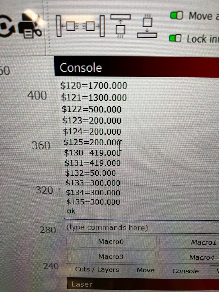

Also, can you go to console window and type $$ then enter and paste results?
It is a 20w laser. The wood is 1/8"

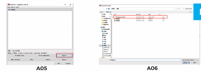

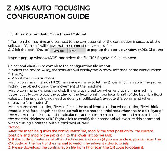

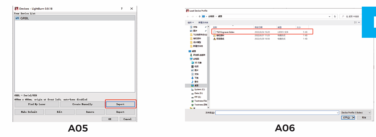

Apparently you have to load a dev. file.
TwoTrees Download (twotrees3dofficial.com)
I tried to saved the gcode and put it on my desktop then down loaded GRBL and tried to run the same square and it did exactly the same thing. I could see the little blue dot but it did not leave a mark on the wood. My Malwarebyte protection would not let me go the two trees any more. Says a trojan is there hitting me. Its got to be a good site maybe I just need to disable my protection. Would that file be my issue?

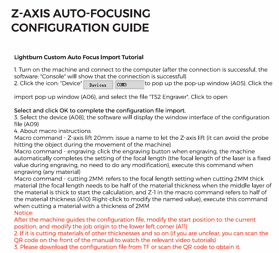

I guess you have auto focus you also need to set up. Which may be your problem.
No I just have that 3 step block to manually set the height. And could not find any instruction on which step for what level of cutting or engraving. So tried them all.
